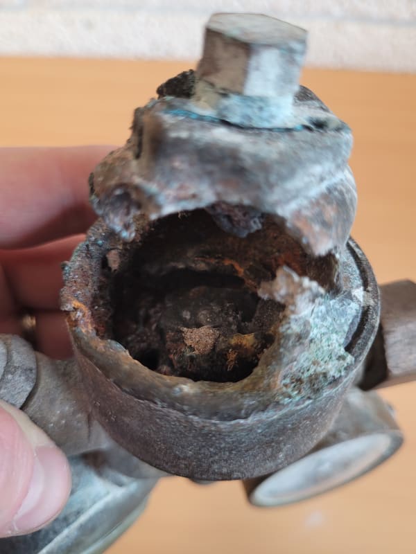

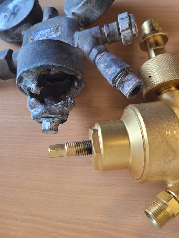

A video of an oxygen regulator failing an ASTM ignition tolerance test. The report
The problems set here is not just the adiabatic re-compression temperature reached, but also that any small motes of material loose in the pipeline release energy when they hit things like pipe walls. This can result in "kindling chain ignition" at lower than expected temperatures.
FacEngrPE: Interesting! Aluminum regulators in combination with oxygen(!) Now I have seen everything...
You are correct, and as I said earlier to georgeverghese there are many ignition mechanism in an oxygen system, the most common one being particle impact ignition and of course compression heat. The design process for an oxygen system is never easy; especially since the existing requirements for operators using such a system is often too relaxed.
I have attached two images of a pressure regulator that ignited a while back, causing severe, permanent, bodily harm to the two operators in close vicinity. The 2nlet pressure was approx 200 bar, and the outlet pressure was 10 bar. Cause of ignition: poor operator handling in combination with particle impact.

georgeverghese: Oh absolutely! Any area where an oxygen enriched conditions can be reached is to be taken very seriously. Take hospitals for example; a tiny leak from an oxygen tube can easily make so-called "non-flammable" textile materials burn fiercely.
Interesting what you say about the O2 recip compressors, I didnt know that!
I'm swerving off topic here but it is an interesting discussion:
When it comes to materials my company have been using 316L for high pressure oxygen piping since the 60s, with no accidents. The exception is pressure regulators, fittings, distribution manifolds and filling adapters. In these applications nickel-copper alloys, brass or Monel 400/K-500 is a must. That being said - in the last couple of years a lot of the larges gas companies have started phasing out all use of stainless steel due to oxygen safety. I wouldnt be surprised to see all of the stainless steel piping being used today being phased out within 5-10 years in most of Europe. At least that is the indication that we are getting from our customers as of late.
