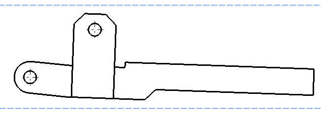

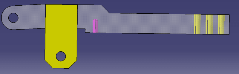

I have a 3D object, and now I want to automatically generate a front view using a macro. However, the projection is tilted. Is there any way to make the projection straight?

Set drawingView1 = drawingViews1.Add("AutomaticNaming")
Set drawingViewGenerativeLinks1 = drawingView1.GenerativeLinks
Set drawingViewGenerativeBehavior1 = drawingView1.GenerativeBehavior
'Set partDocument1 = documents1.Item("Part4.CATPart")
'Set product1 = partDocument1.GetItem("Part4")
Set prod = oCurrentDoc.Product
drawingViewGenerativeBehavior1.Document = prod
drawingViewGenerativeBehavior1.DefineFrontView xDim, yDim, zDim, xDim2, yDim2, zDim2
drawingViewGenerativeBehavior1.Update
