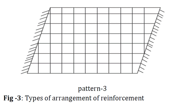

Tstruct - Suggest taking milkshakelake's advice, orthogonal rebar. The problem you are working on comes up often with some of the rebar in skewed (angled) bridge decks. Rebar intersections can be either orthogonal, or not. It's done both ways depending on the skew angle. Here is the orthogonal concept:
Investigations indicate orthogonal placement is somewhat better. See:
"Effect of Reinforcement Pattern on the Behavior of Skew Slab"
