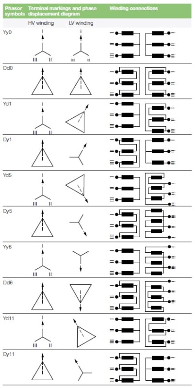

Phase rotation will be determined by the source. If you started with ABC, that's how you end. Bushing reconnections do not change phase rotation, only the phase shift.
From Schneider.
D1 & D11 have different ways of connecting the delta. I don't think just swapping phases is going to cut it.
Muthu
Take the diagram for Dy1 and renumber the top and bottom primary and secondary terminals. Make the top terminal III and the bottom terminal I. Now, primary Terminal III is connected to the right side of the Terminal II coil. Primary Terminal II is connected to the right side of the Terminal I coil. Primary Terminal I is connected to the right side of the Terminal III coil. Identical connections as Dy11.
