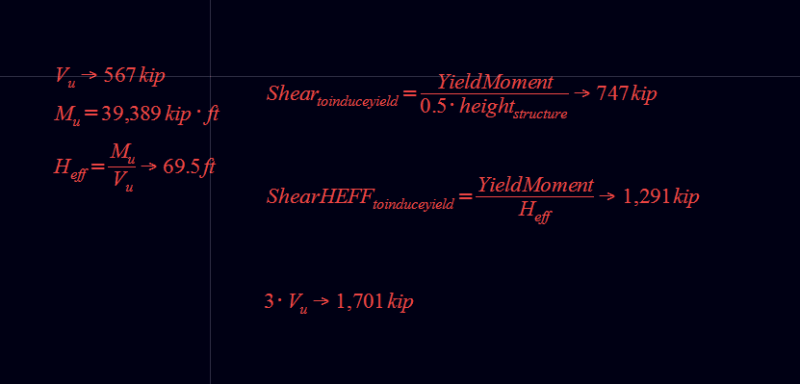

For example, in our building, we are looking at a sample wall, ~4' wide, 22'-9" long and 240ft high.
Vu = 567 kips
3*Vu = 1701 kips
Doing a plastic analysis on this wall, assuming a conservative value on the location of the shear load on the wall, 0.5 * h, the shear to induce flexural yielding = 747 kips. This plastic moment capacity was calc'd with 1.25fy.
Some sample calc's shown below:
Can I limit my design shear to 747kips instead of the 3*Vu value of 1701 kips? There does not seem to be anything in ACI 318-19 that states you can limit Ve to be the plastic shear to induce flexural yielding of the wall, but that seems to be what is at the heart of the code.

Thanks for this reference, it helps to keep reading the code, I see the definition of Heff in fig R18.10.3.1.
The way I see it written though, H eff = Mu/ Vu, not Mu / Ve (3*Vu).
This yields the following results:
Using 70ft for Heff still yields about 410 kips of less shear to design for as compared to the Ve = 3*Vu.
Is it acceptable to design to this reduced shear?
No, because you're missing the dynamic amplification factor and guessing at the real effective height. You've already found the yield moment Mpr, which is required to determine Ωv = (Mpr / Mu). ΩvVu then needs to be amplified by ωv to capture higher mode effects. Once you've found Ve = ΩvωvVu, you can determine the actual effective height using Mpr / Ve (as chris3db described above) and compare it to your initial guess of 0.5H, but it's unnecessary.
The effective height concept is useful for illustrating the shift in vertical force distribution up the wall and perhaps for preliminary design, but that's about it.
