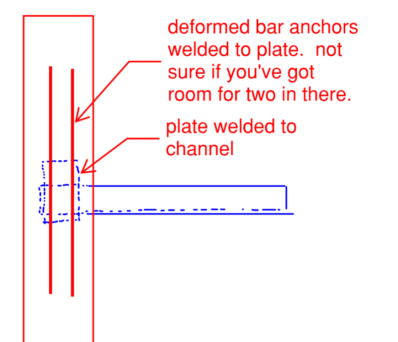

CovertShear said:
Anyway so my next step was to kinda borrow their concept, only I will use UPE U-channels (higher bending stiffness) instead of their product.
I like your concept in general but feel that you ought to go even further with respect to mimicking the halfen setup. My concerns pertain to the use of the vertical channel piece embedded within the panel:
1) Will it be disruptive to the successful concreting of panel and, more importantly;
2) Will its flexibility be incompatible with the surrounding concrete.
When you look at a lot of common precast connection typologies that utilize steel hardware, a common theme is that they transition from structural steel to reinforced concrete as soon as practical. I believe that the reasoning for that is my #2 above. See the sketch below for what I consider to be an improved version of your scheme.
@KootK
Interesting, I did not know that, but it makes sense, especially the flexural incompatibility part.
Thanks for you design, I like it. Especially the plate welded to U-channel to which the rebar will be welded.
