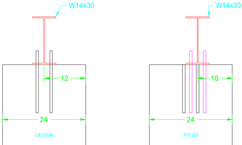

I was informed that the concrete pier was installed 2" off the mark. The steel structure is pre-fabricated and there is no way to move the steel. I was asked if they could cut the cast-in place anchors and drill new holes shifted 2" for post-installed anchors. I'm concerned because the new anchors would be 2" away from the cut, cast-in anchors and therefore wouldn't those create a spacing or edge distance issue? See below. It is a square footing with a circular pedestal. The black dots are the cast-in anchors and the purple dots are where the wedge/adhesive anchors will be. There was only 4" between the original anchors (front-to-back) and by shifting it 2" a new anchor will be directly between the (2) existing anchors.

An I-beam bottom flange is the "base plate" and if we don't move the anchors, the original location would interfere with the web of the beam.

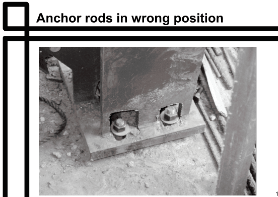

Here is a snip from AISC Field Fixes to Common Problems.

@ GC_Hopi
this is disastrous solution, are you sure its from AISC Field Manual !
@adn26
Dont shoot the messenger. You can make your own engineering judgement call.

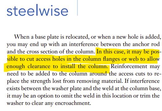

Here is the language from Steelwise.
I remember that image from an old AISC presentation. I think it was a presentation by Dr. Fisher on "Field Fixes and Solutions"
If I am remembering right the image was presented as a case that the contractor made their own "fix" and one that looked pretty bad. However after evaluating the condition and the loading requirements, it was found acceptable.
So not exactly a field manual - but an acceptable fix for some cases/conditions.
The presentation is probably still available online through AISC's website
Good memory RWW0002 and it is not a field manual. I stated the source in my original post.
Ok,
So here is what it would like under the proposed change.
