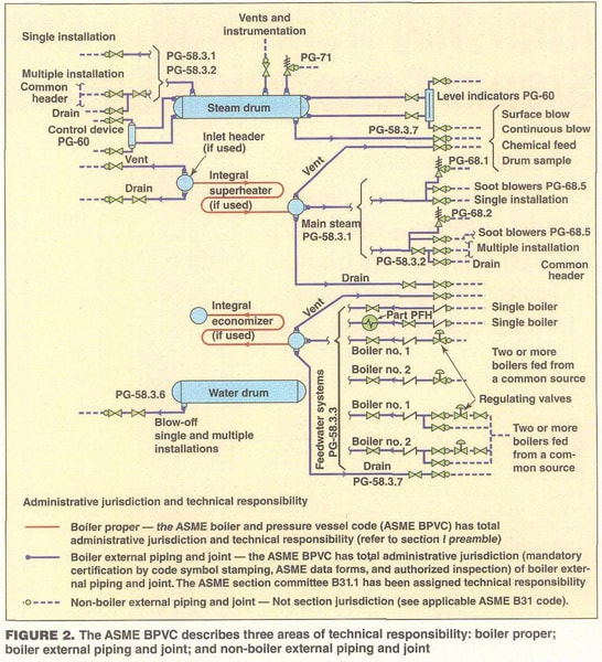

pipe in a boiler, designed according to ASME B31.1 standards
ASME B31.1 is for piping external to a boiler. inside a boiler the piping is designed and constructed to the ASME Boiler and Pressure Vessel code. See the following and the code for details.
