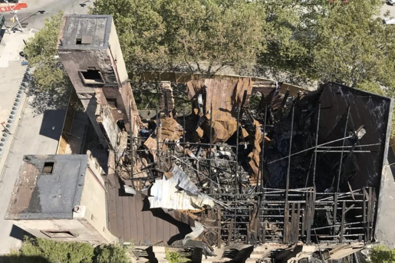

Engineers Warned Landmarks Commission Salvaging a Synagogue Would Be Dangerous. Then a Worker Got Crushed to Death.
"the general counsel for the landmarks commission had “instructed” him not to again bring up his recommendation for a full demolition so as not to “offend” the commissioners who were insisting that parts of the deteriorating building must be retained."

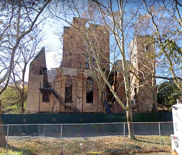

Google Street View location or this side view.
The gable end looks particularly hazardous. It shouldn't have taken much of an evaluation to recognize it's lack of stability.
Debris resting against the side is also easily recognized as particularly hazardous even to shore up.
ny.curbed.com
