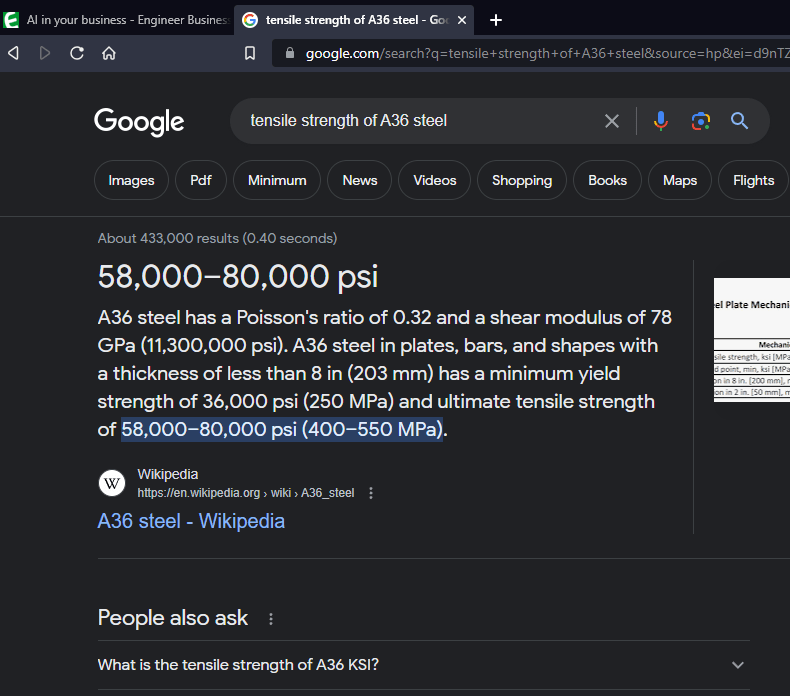

IlliniEI said:
I wonder if you had put "ultimate" if it would know better.
I don't know. I doubt it.
Google didn't have any trouble with this, in 0.40 seconds!
