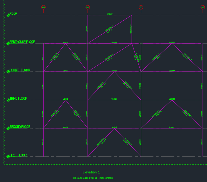

Is this an in-plane discontinuity in the seismic system? Here's what my framing looks like:
I know it's not the best, but I did this years ago. Now it's under audit and a regulator is saying it's a vertical irregularity, which I tend to agree with. However, I would like to defend myself. From my understanding, a vertical in-plane discontinuity would impart overturning moment-load-transfer discontinuity. This would require amplified forces for the columns and the collectors (horizontal link connections between bays).
In this case, I'd say that the entire vertical lateral system is one big truss, so there is no discontinuity. I'm not sure how I'd justify that reasoning or if it makes sense, so I'm looking for some guidance.
For context, the applicable code is ASCE 7-10, seismic category is B, and the following code applies:
Table 12.3-1. In-Plane Discontinuity in Vertical Lateral Force-Resisting Element Irregularity: In-plane discontinuity in vertical lateral force-resisting elements irregularity is defined to exist where there is an in-plane offset of a vertical seismic force-resisting element resulting in overturning demands on a supporting beam, column, truss, or slab.

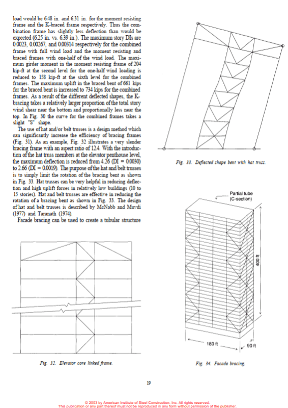

The fundamental difference is that the offset shear wall is not strictly connected to a direct vertical load path, whereas in my case, it's like a truss with staggered diagonal supports that all connect. My situation is more akin to what is described in AISC Design Guide of Low-Mid Rise Structures, showing a hat truss concept:

This looks like a vertical discontinuity to me. I'm not sure I buy the "one big truss" argument as you don't have a direct load path to the foundation via bracing; rather, you're transferring load in and out of adjacent bays via collectors. Not sure classifying this as an irregularity would have impacted your design since I'd imagine you would have designed the collectors and columns for overstrength anyway, but I'd have to check if that's actually required in SDC B.
Edit: In addition to the in-plane discontinuity, it also looks like you may need to evaluate whether you have a weak or soft story at the 1st and 3rd levels.

This seems very subjective, but to argue your side:
[ol 1]
[li]ASCE 7-10, Code Commentary Section C12.3.2.2 states: "Vertical lateral force-resisting elements at adjoining stories that are offset from each other in the vertical plane of the elements and impose overturning demands on supporting structural elements ... are classified as in-plane discontinuity irregularities." You could make the argument that there is no offset where the elements meet at the adjoining story.[/li]
[li]If the whole purpose of identifying this type of discontinuity and providing overstrength is to protect the gravity load carrying system below, I don't see the risk here unless you're relying on the beam at the penthouse level to support the column above. This doesn't seem to be the case, though, considering that you have diagonals below.[/li]

I don't think the discontinuity in this frame is that pronounced or particularly egregious in terms of violating underlying ELF assumptions of uniform stiffness and distribution of nonlinearity. But if it's being flagged by an auditor then the "burden of proof" lies with you and you seem to be facing it head-on with humility instead of reacting with ego, so kudos to you for having a healthy attitude abotu it.
That being said, one analytical way to defend your design might be performing a scaled modal analysis. By doing so, you're 1) defending your design by showing it works as-is (potentially), 2) respecting the audit engineer, and 3) showing you're a badass engineer who knows how to do modal analysis :-)

Quick update, I decided to "fight" the objections and used all the code references y'all sent, and it worked! The thing that probably helped most is ASCE 7-10's definition of offset.
