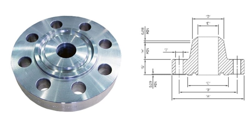

one of my clients wants to rebuild a small pipeline of a old project ('80 years), which consists of a tube from rolled plate and welded at the both ends 2 flanges as sketch below:
These flanges are welding neck and they also have a small strange cave for O-Ring gasket, as you can see.
Do you know any ASME/EN/DIN standard related to this kind of flange available on the market or do you think it's a special one, so I have to get from forged bar by mechanical working?
Thank you

Figure 6 of ASME B 16.5 has dimensions.
If it is an O ring I'm not sure what flange type applies so might be a special. Anything stamped onto the flange itself?
Yes it looks like a Ring Type Joint to me. Check the groove dimensions against those in Table 5 in ASME B16.5.

Nope, it's not a classic RTJ acc.to B16.5.
Please notice that the internal part after the "groove" is higher than the finishing surface of flange (you can see clearly in the sketch).
I think it's more similar to EN 1092-1 TYPE H here below:
but also in this case dimensions don't match with EN 1092-1 flanges.
And sorry I don't have photos :-(
What are the dimensions then?
Does it not mate with Type G?
