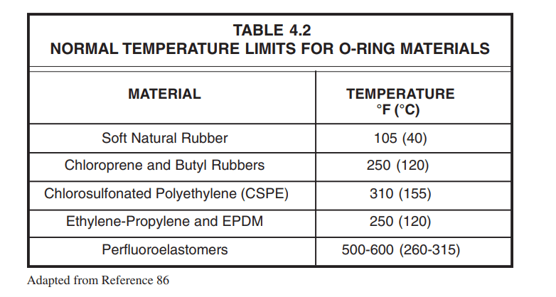

This is for stronger acid than yours, but might provide some good info.

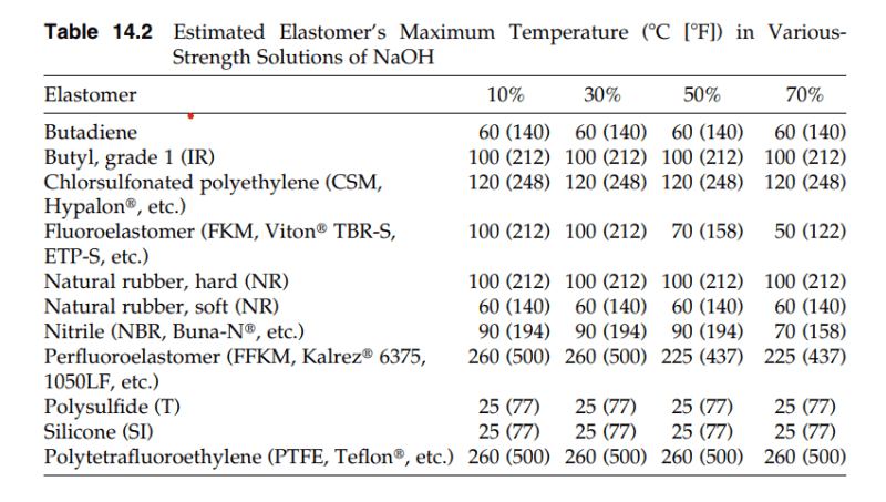

This gives some values for lower concentrations as well in Caustic.
