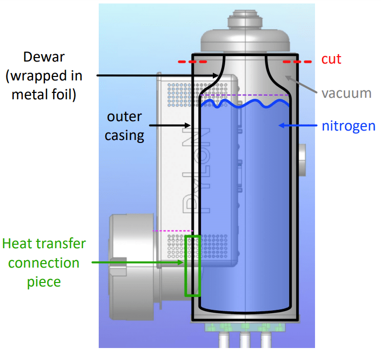

I need to fix a leak on the inside of a liquid nitrogen dewar which acts as the coolant tank for a spectroscopy CCD camera. Due to the design of the camera, I unfortunately can only access the inside of the dewar via its bottleneck. Since the dewar is permanently connected to the camera body, the only idea I could come up with is spraying the inside with a material that hardens afterward, hoping to hit the leak in the process and therefore sealing it while also not depositing too much material. I roughly sketched the idea.
Let's suppose the dewar is made out of aluminum. Which material would be suitable to be sprayed onto the inside, adhering well to the aluminum after hardening and can be expected to withstand rapid temperature changes and low temperatures (-200 °C) over long periods of time?

If you spray "stuff" in the dewar, how do you keep it away from the camera ?
I think the camera is technically outside of the Dewar interior like below. In general Dewars cannot be disassembled, since its mechanical integrity is what keeps the vacuum from leaking.

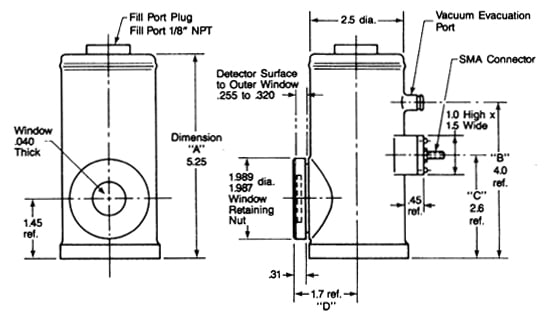

We don't know the size of the leak, but I suspect it to be more of a hairline crack. Since the dewar is permanently connected to the camera's casing, we can't take it out and our only access to the inside is via the bottleneck where we usually refill the nitrogen. Just refilling nitrogen does not help by the way because the dewar must be surrounded by a pressure < 7e-3 mbar. This means currently there is a vacuum pump attached to the camera pumping gases away between the dewar and the casing. With this crack, we can only maintain such a pressure for about 15 hours while continuously pumping. Without leakage, concurrent pumping would not be required. See image for more information on the camera's construction
We have tested for leaks and all connections on the outside seemed to be functional. When we put the helium tube through the liquid nitrogen filler neck however, the pressure increased significantly
