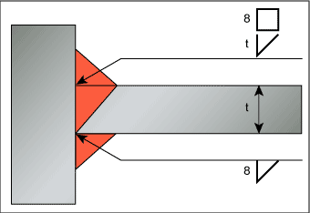

Weld symbol for a stiffened single bevel butt weld
user277418
Jul 11, 2017
86
Hi
What is the correct weld symbol for a weld like that? ISO system
Regards
What FW means?
I know ISO 2553 but there is no such case
If you have a detailed drawing, why would you want a weld symbol?
Regards
this is just a picture from internet with the joint I want to specify. is not an actual drawing
But thank you all for the help. kingnero's answer is something I have expected to use eventually, just wanted to be sure there are no standard symbol for the case in the ISO system
