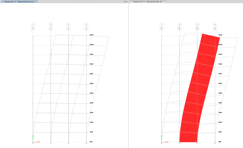

I ran an ETABS model to verify this effect. I used the member sizes and spans listed with a 12' floor-to-floor height. My seismic loading is a Y-direction only ELF load.
The snips below show the elevations of the exterior frame and the shear wall frame. The results for the exterior frame have all columns grouped as one pier, so the total shear reported is spread over the four columns. The shear wall frame has the walls as a pier and separately shows the shear in the frame elements. You can see that there is in fact load reversal in the top level of the wall.
Here's a snip of the deflected shapes for the same frames:

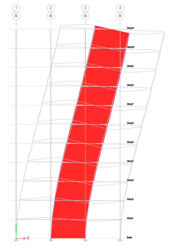

Here are the superimposed deflected shapes. At the top, the wall must want to move further in the direction of the seismic forces, and the frame starts preventing the wall from moving. I haven't fully wrapped my head around the 'why' of this phenomenon, though.

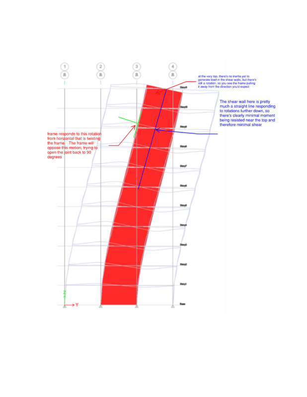

Some of this is element relative stiffness, but I just noticed a thing I've never thought about before. The shear walls respond based on rate of change of rotation (i.e. moment). The frames, though, respond fairly heavily based on rotation at the floor level where they frame in rather than the changing rotation of the structure as a whole.
See my sketch. This would explain why the frames take a fairly consistent amount of load.
This is just my pondering. I have nothing corroborating this other than looking at the diagrams in the thread.
The screenshot below illustrates what is happening. While frames tend to displace in shear, walls tend to displace in flexure. Load is proportioned to the frame and wall based on relative stiffness. Because the wall curvature in the lower stories induces such large displacement at the roof, the wall stiffness at the upper stories is very small compared to the frame. However, since the wall and frame are rigidly linked to each other by the floor diaphragms, their displacements must be compatible. This causes the frame to "push back" on the wall at the upper stories to make the wall displacement compatible with it's own displacement. So the shear resisted by the frame at the roof is the story shear plus whatever amount of force is required to push the wall back to a compatible displacement.
This is the same thing as what THLS and deker both said. I just find that it speaks more to my intuition when I consider only a load at the top and VLFRS's of uniform stiffness over their height.

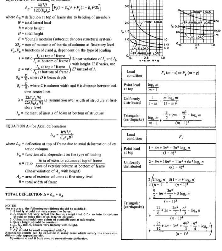

I've included a few of the PCA document procedures in the clips below so that OP can get a flavor for how much fun that might be by hand. It's not for the faint of heart or those with fading HP32S batteries.
