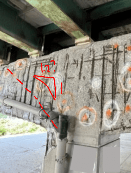

Good day all.
We are evaluating some deteriorated hammerhead pier caps. The caps would qualify as “deep beams”. We know that for deep beams, design should be by Strut and Tie method (STM), rather than by Sectional method used for shallow beams.
But that’s for design. We are doing analysis here, not design.
If we use Sectional method to determine moment and shear capacity of this pier cap, will that be acceptable?
I think Sectional method is less accurate for deep beams, but is more conservative (lower bound) in determining capacities. Sectional method uses formulas like Vr (shear resistance) = Vc (concrete contribution to resistance) + Vs (steel contribution). Depending on the code you use, Vc and Vs will have certain expressions involving material strength and member geometry.
You're analyzing "a design" what's the difference? From the photo it looks like the distance from the fascia to face of column is greater than the cap depth, beam theory should be OK.
From experience, it may not be worth repairing.
BTW- is this bridge in NY? The shape of the column and sage green paint made me wonder.
Someone is even thinking about not replacing that deteriorated mess ?!?

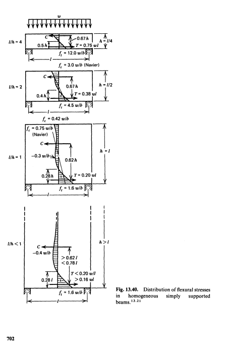

That will be an erroneous assumption in many cases. One of the reasons that STM exists is to address the situation with deep beams where sectional theory underestimates the depth of the compression block and, therefore, underestimates the amount of flexural reinforcing required.

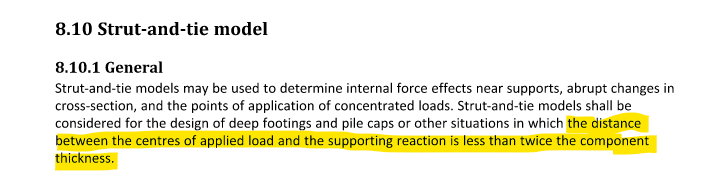

I don't feel that it will. A common criterion is to use STM when shear spans are 2.0 or less.
@bridgebuster:
North of the border, we require STM when a/d < 2.0.

Until they are replaced, we need to make sure they are able to carry the load. Hence the need for evaluation.

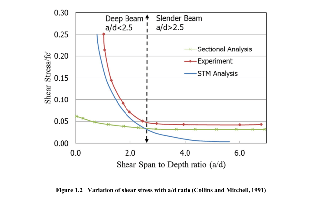

Thanks for pointing out the flexure part. I was mainly thinking about shear. As researchers indicate, Sectional Method underpredicts shear capacity for deep beams, like the following curve.
When these bridges were designed in the 1960s, STM did not exist. So I thought using STM for analysis would be comparing apples to oranges.

I would definitely consider encasing that pier in 6" to 8" of concrete assuming it doesn't have a capacity issue.
Likely repair method will be:
1. Chipping concrete a little bit (50 mm) to expose the outside steel.
2. Doweling staple shaped bars to replace heavily corroded stirrups.
3. Adding Cathodic Corrosion Protection to mitigate future corrosion. These are zinc bars that form an electrical circuit allowing sacrificial corrosion of zinc in lieu of steel.
4. Form and patch 100 mm self-consolidating concrete.
Shotcrete will not likely be considered as it might damage the corrosion protection system by impact.
Neat. May I ask which publication that comes from?
