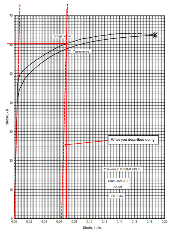

Hi All,
i received a stress analysis done in abaqus and have a question as using Inventor Professional 2022 to do similar analysis. In the received report instead of the stresses it talks about residual plastic strains in the material. If i want to do a linear static analysis in Autodesk inventor software, is there anyway that i can find what linear stress is equivalent to the strains I’m getting from residual plastic strain? The plastic strain reported that under load the strain is 0.07 and material wont collapse. the material is aluminium with Young modulus is 70 GPa. Is it correct that I say if i draw a line with the angle equivalent to young modulus on stress-strain curve and crossing the strain of 0.07, it would be my linear stress equivalent to plastic analysis?
actually, i m looking to find what maximum stress i need to aim to in my linear analysis to have the same strain in the material as was done in abaqus analysis. thanks in advance,
No, not at all. See the figure below. If you follow that method, all you will do is figure out the plastic portion of the strain. Remember, that value of 0.07 in/in is the TOTAL strain (both elastic and plastic). If you take the Young's modulus and intersect as you say, the abscissa will simply read off the plastic portion of the total strain. I also don't understand how you intend to read off a stress using that technique.
Stress_Eng said:
One way to do this is to use the Neuber method.
It is true that the Neuber technique assumes the elastic stress-strain product is equal to the plastic stress-strain product. This is an assumption - hence why it is called a "rule", not a theory. Generally you could indeed follow the Neuber parabola in either direction provided you know the correct Ramberg-Osgood parameters. However, I would NOT recommend doing that in this case.
Nueber is a pseudo-nonlinear technique that is hyper-localized based on notch root strain. It does NOT account for non-linear behavior of the entire component. So if the report you are referencing has done a complete FEM analysis with non-linear material based on a Ramberg-Osgood curve, it won't inherently show correlation with Neuber. Bascially, mixing and matching non-linear techniques...not recommended.
