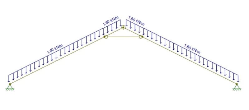

I am trying to model this roof on FTool but having a difficult time understanding if I am analyzing correctly. I tried playing around with height of collar tie and even adding a ceiling joist but unable to reduce the lateral load to something acceptable which tells me my model is not acting right.
Model:
Modeled with high collar tie:

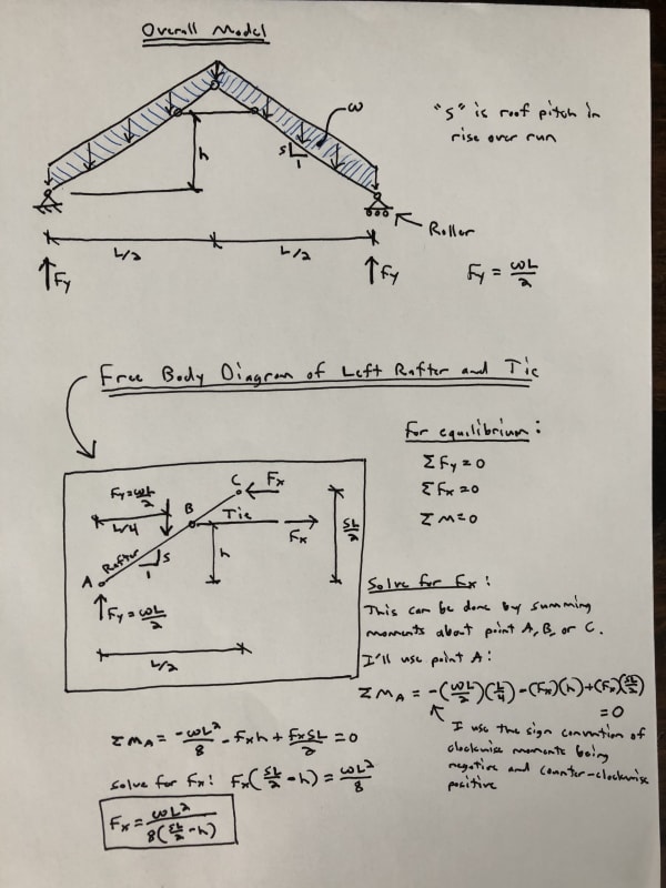

And just so I can get a better understanding of the system,
Eng16080 said:
To verify your software model, you should draw a free body diagram and create a simple spreadsheet to solve for the collar tie force.

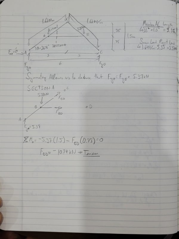

Is this what the FBD is supposed to look like?
By free body diagram, I meant to look at the forces specific to the tie. The picture you show is a model of the full truss. Regarding your model, if you're trying to analyze the scenario whereby the tie is resisting the outward thrust and the walls are not, then you should use a roller (not a pin) for one of the supports. For the force required to be resisted by the walls, then modeling as you have it shown is fine.
Here's what I meant by Free Body Diagram:
Rather than using your loads in the free body diagram, I solved for the tension force (Fx) in the tie for any general case of roof pitch (S), uniform load (w), and tie height (h). This makes it easy to mess around with the tie location to see how screwed you are trying to make this situation work.
For your specific case then, using w = 1.60 kN/m, L = 6m, and S = 3/12 = 0.25, we get:
Fy = wL/2 = 4.8 kN
I'm not sure exactly what the distance of the tie to the bottom of the rafters is, but it looks like it's around 0.6m
Fx = wL*L / 8*(SL/2 - h) = 48 kN
Interestingly, the force on the tie is exactly ten times the vertical reaction at each support.
So, for this to work, the tie would need to resist the 48 kN force (doable), the rafters would also need to resist this point load (unlikely), and finally you would need to design a connection between the two capable of transferring this force (unlikely). Technically, there's also an axial force acting on the rafters (which is usually ignored in rafter sizing).
Now, if you were curious what the force with the tie at the wall plate height would be, then use h = 0. This also gives you the horizontal force that the top of the walls would need to resist if there were no tie.
TORCHMAN:
Your model is incorrect. The two base pin supports are shown as fixed horizontally.
In reality they both are able to move outward horizontally as the top of the wall has no stiffness to resist the lateral thrust of the roof frame.
Your should model one support as a roller - exactly like what Eng16080 shows in the sketch.
This will make sizeable changes in the frame behavior and forces.

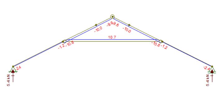

My model was like ENG16080 had suggested, to yield forces for my wall to resist. Which I now know the top plate will not work.
ENG16080, I Checked FBD. Seems like the force I got is much lower and confirmed by the model once roller was added on the other side, maybe a doable connection with 2 collar ties.
Now I wonder about the physical connections and deflection. The deflection the model yields (using SLS loads) is about 42mm which is too high I wonder what the acceptable deflection would be? In reality, would this deflection be split on each side? Also, would the connection between rafter and top plate look like since it should not be fixed horizontally? Just the rafter bearing on the top plate with no screws?

Regarding the 42mm deflection, you indicate that is horizontal. What is the vertical deflection?
Your analysis is mostly in agreement with mine. The difference in value is due to:
[ol 1]
[li]I had assumed the tie was nearly at the top of the rafter, based on the picture of the model you provided. In your FBD above, you show it half way up the roof, instead, which results in a much lower tension force which also happens to be exactly double the vertical reaction.[/li]
[li]In your FBD, your roof pitch is actually 6:12, not 3:12 as you stated initially.[/li]
[li]Also, you apply your snow load to the length of the rafter (3.35m), whereas you should use the horizontal projection of the rafter instead (3m). Using the full length is slightly conservative and probably ok if this is what you intended to do. You would use the full length for dead loads (which you should also be accounting for). If your 1.6 kN/m load is snow plus dead, then I can see the logic in what you did to avoid having to separate the loads.[/li]
[/ol]
Accounting for those differences, my calculation matches yours based on the tie height and roof pitch. The tension force is now much more reasonable in terms of getting a solution to work. You may still have trouble getting the rafters to work with the massive point load at midspan and designing a connection to work.
How are you determining that the deflection is too high if you don't know what the acceptable deflection would be? I would compare the vertical deflection using only the snow load to L/360 or L/240 if there are no brittle finishes applied to the roof/ceiling. Your L would be 6m or the full width of the roof.

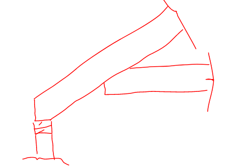

PLEASE CONNECT THE RAFTERS TO THE TOP PLATE! In the idealistic model that you've created of the roof, we're making the assumption that the top of the wall is not capable of resisting any outward/horizontal force. Technically it will have some capacity in this respect, although minimal. Any small capacity that the wall has should add to the overall strength of the roof and provide redundancy.
Yes sir! Another local engineer I brought this problem to told me the best way to idealize it would be with a spring, which I think makes sense.

The deflection I am referencing is horizontal. I typically use L/500 for horizontal deflections from floor to floor - the ceiling will be drywalled: 3000mm by 500 = 6mm. Using option 2 mentioned above, adding the collar tie at the top and a low rafter tie, I got the deflection down to 20mm total, so 10mm each side. But with the idea that the top plate of the walls have some resistance and are really springs, I imagine that the deflection will be much lower.
