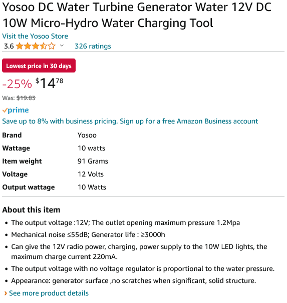

Amazon?
Screenshot_2023-09-11_at_08-20-32_Yosoo_DC_Water_Turbine_Generator_Water_12V_DC_yujju7.png

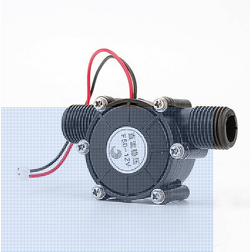

Judging from better specs on another similar unit, the open circuit voltage may reach 80 Volts or more with enough water flow/pressure.

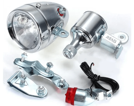

An old style bicycle magneto with a matched bulb or LED would be a better choice.
