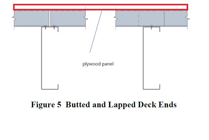

Just went back to look at a recent project and the architect had called out UL P523 for the roof assembly.
Looks like that assembly allows for either metal deck or plywood. If plywood is used, min. 20 Ga purlins or hat channels can be used to reduce sheathing span to 24". I feel like purlins would be tricky to install unless they prefabbed truss module groups on the ground first. With metal deck at least they have a work platform to stand on as they go.

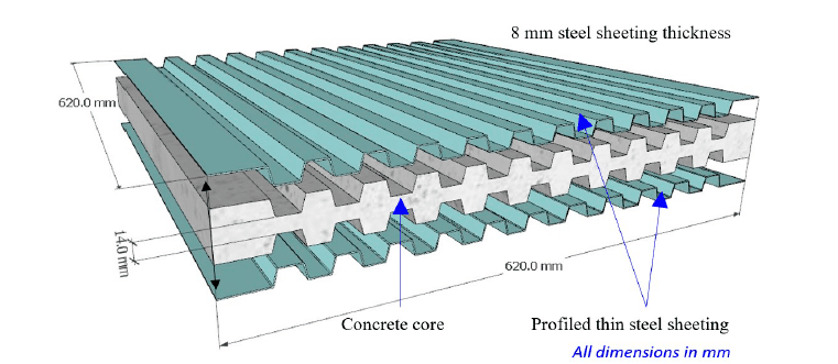

Could you use two opposite "corrugated sheets" as composite section ?
without the concrete [tongue] of course.

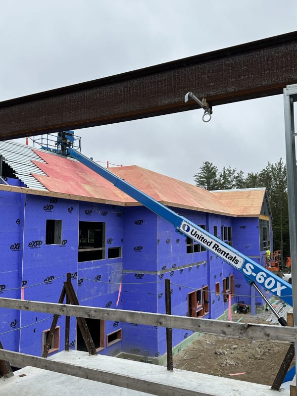

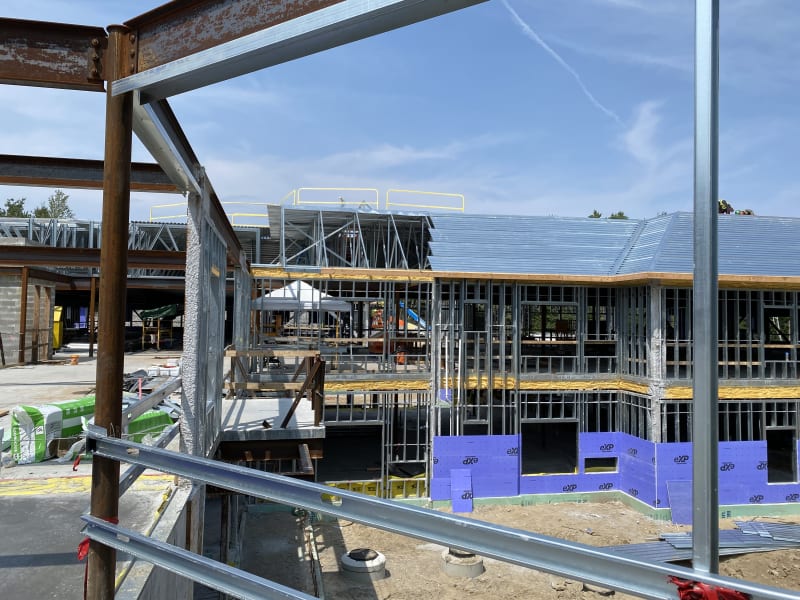

ALK2415 - that corrugated sheet is the same thing that I referred to as metal decking. Here are some photos of a recent project with this roof system. First photo shows the metal decking being installed and the second photo shows the plywood layer being installed.
Maybe this is the best roof option available for this type of building system, but it would be nice if there were some alternatives that could span 4 ft. I'll ask the contractors I know what they think about the 1" plywood option. The predrilling requirement sounds like it would be a significant drawback.

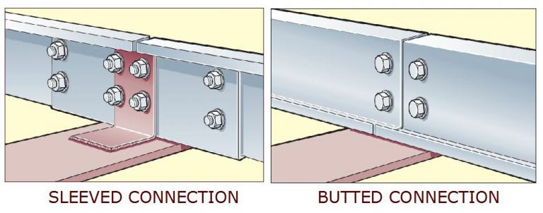

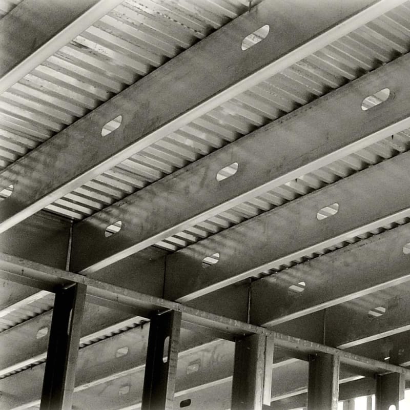

Transverse CRS C-shape might works ?
the connection between Truss/joist (top chord) will be a problem though ..
using continuity connection [splice/overlapping] between each two-spans [like third picture] might solve this !
