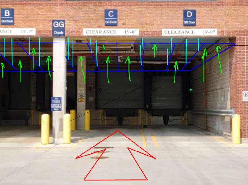

hello to everyone this is my first post am glad to be part of the community , i have to check a hanging ceiling it will be attached to a slab concrete by a lot of ø3/8 RB Vertical rods, i need help with the calculation of the uplift wind pressure on that zone i will attach a photo, the blue lines represents the ceiling and the rods, the red arrow represents the wind direction and the green arrows repressents the wind pressure, i have been studying the components and claddings chapter on ASCE 7-16 but i am not sure

You are on the right track. This has always been confusing for structural engineers. Is this an overhang? Or is it an open structure? I have typically considered it a building overhang, but I look forward to what others have to say.
DaveAtkins

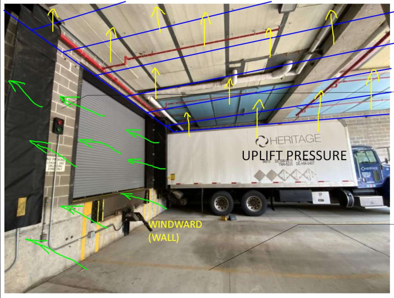

What you are looking at is a soffit. In ASCE 7-10 Figs. 30.7-2 & 30.10-1, soffit pressure is the same as adjacent wall. I would only use overhang pressures if the member has wind acting on both the top and bottom.
Thanks both for your replies,Dave Atkins and DanKile, so just to be sure about it, the ceiling we are going to install is based on W Sandwish Panels,and it will be attached to masonry walls at the perimeter, overhang pressures are used when wind loads acts on the top and bottom surfaces, i think that in my case the wind will act only on the bottom surface because of the seal between the walls and the ceiling at the perimeter, so the correct load to use here is the windward on the adjacent wall? correct me if iam wrong

You'll want to look at both the positive and negative wall pressure (windward and leeward).
And dead load will work against the uplift (positive wall) and with the suction (negative wall).
