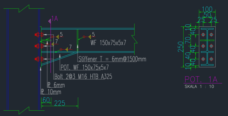

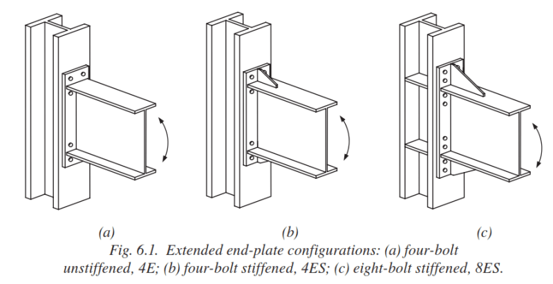

Hi, I was recently curious about beam-column joint on a steel, especially WF profile. I realize than when designing a moment joint you can refer to AISC 358 as you can see in the image below.
The company I worked in has this sort of beam-column joint detail for every profile there is
The detail provided by AISC and my work place seems to differ a lot. Well my question is, since AISC specified a configuration of bolts and the equations used in it were specified for that kind of configuration, On the other hand I wanted to study how did my company came with this kind of joint configuration. Can you help me provide a book or a youtube channel, or something that help me understand the basic principle of beam - column joint on a steel. So that no matter what the configuration of the bolts or welding in the joint, I can calculate it using those principle and not using the configuration provided by the ASCE
Thank you

I just got an updated copy of the AISC design guide #39 (DG_39-End_Plate_Moment_Connections)
which likely handles the type of connection you are looking at. It's generally less costly to go to a thicker end plate than to use stiffeners between the bolts. You may, also, be able to eliminate the T shape at the underside of the W6. The lines at the fasteners, on the bottom, are actually 'dashed' and represent yield lines. The image is for the tension at the bottom. If the tension is at the top, the the second pair of bolts (above the bottom flange) can be eliminated, and the connection checked for that configuration. The AISC accommodates:

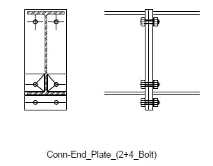

Here is the way I see this connection:
1) When moment causes the bottom flange is in tension this connection is a haunched end plate connection. I think that is covered in AISC Design Guide 12. At least for the design of the haunch for slenderness and such. For bolts, it's just an extended bolted end plate connection. And, you can ignore the compression side bolts.
2) I don't like the way you do your haunch all. Looks expensive. I usually just form the haunch out of a WT. So, the stiffening portion of the haunch is perpendicular to the column. Easier bolting, easier welding, and less welding.
3) When moment causes the top flange to be in compression, it is just a flush end plate moment connection. You again ignore the compression side bolts.
