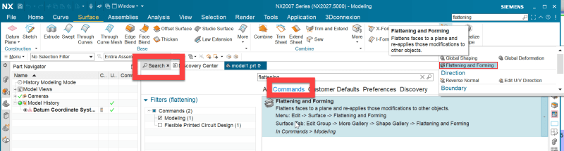

Sometimes I need to know where a command is in the menu drop downs and not just start it up automatically. I used to do a search for the button and could see the path to it. Now they changed the search and I cant figure out how to find where a button is in the menus.
For example, I want to know where the Flattening & Forming button is. I do a search now and at the bottom it simply says "In Commands > Modeling"
I believe this is an operation inside one of the GM Toolkits, so its not a regular standard operation, but nonetheless, I used to be able to do a search for the command and find the location if needed. How does this work with the new search?

When you've done a search, switch to the Search tab (see image) and make sure it's displaying Commands, not All.
This will then show the path to the command and make it available if it's in the role you are using.
