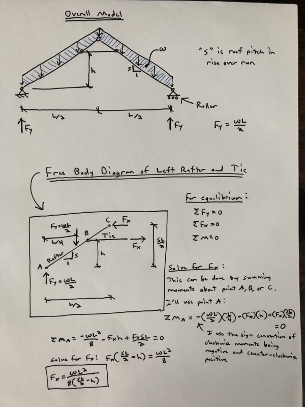

Not sure if this helps. This is from a response to a post a couple months ago:
The equation at the bottom for Fx gives the outward thrust. This is obviously much simpler than the spreadsheet that you linked above, but it could be the starting point for creating something similar.

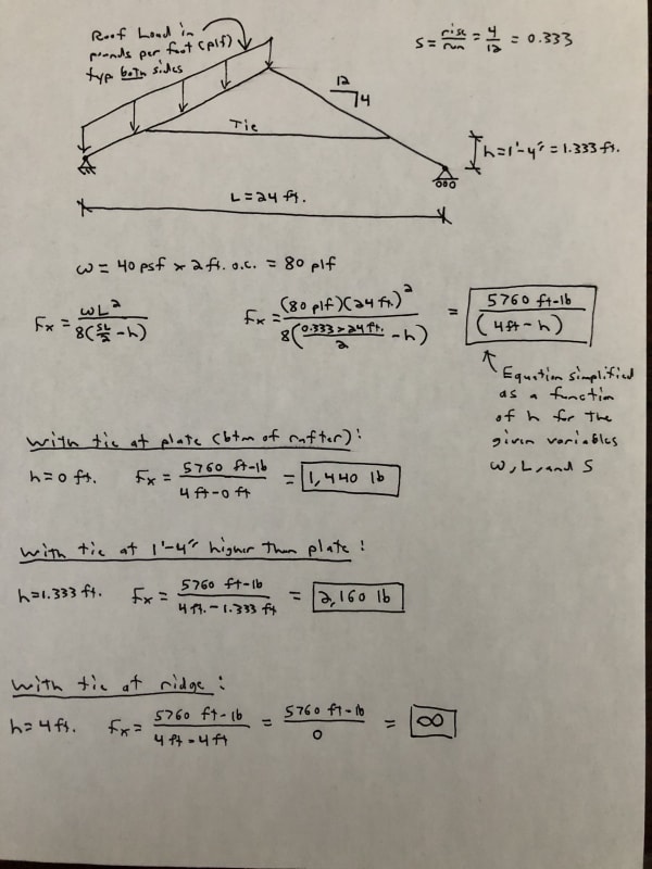

Anybody know if that hand sketch posted matches the published result in the Journal of Light Construction, Truesdale, October 2008?
Regards,
Brian
If you mean the sketch above that I created, then yes, it should arrive at the same reaction as the article. If not, let me know, as I'll need to give my stamp back :)
The article uses different definitions for it's variables than I do. I like to call length, L, the full roof width, whereas they use half the width. Also, the height of the tie, h, in my case is measured from the bottom of the rafter, not the top, which I find more logical as most builders/architects generally describe the tie location relative to the bottom.
The information in the article is good, but I would add a few additional comments, which might be applicable depending on how particular you are. In designing the connection between the tie and the rafter, I would use NDS to determine the allowable nail capacity, rather than base it on 100 lbs for a 16d nail. Based on another thread living here somewhere, some engineers were lamenting how most framers found out in the wild are using nail guns with 0.120" diameter nails, which are a fair amount weaker in shear than a 16d common nail. Be sure to account for that if it's relevant in your case. Also, if the roof is loaded with snow, you can take advantage of a higher load duration factor, CD, which will give a little extra capacity. Although NDS doesn't require any minimum nail spacings or edge/end distances, using the recommended distances found in the Commentary, Table C12.1.6.6 is probably wise.

Concerning the example calculations in that article, by using the equation I derived, you should arrive at the same results for horizontal thrust. Really, both methods are essentially the same. See below:
