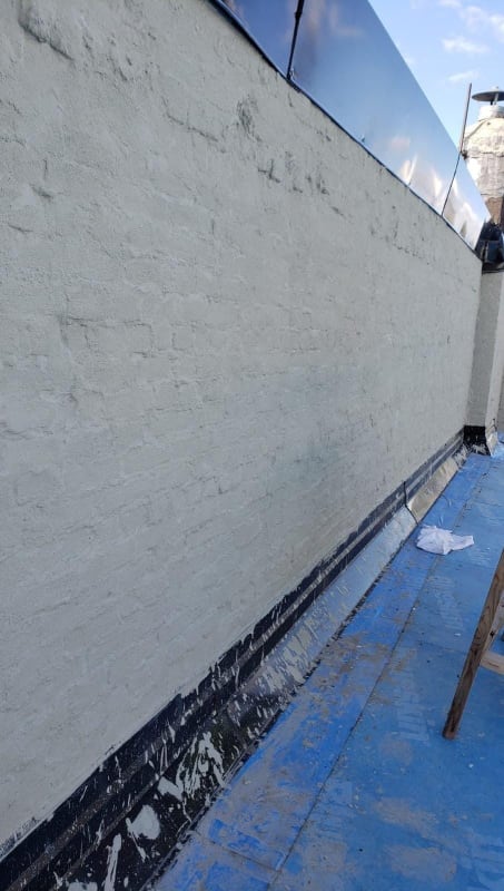

I noticed in your details it calls for some version of brick coating/waterproofing. Is there a coating system that has performed well in NYC for these applications? I always thought the conventional wisdom is that waterproofing or sealing bricks could lead to problems, if the coating prevents the bricks from drying out. I imagine the trick is using a coating that sheds water but breathes vapor.
@bones206 I haven't had any issues when weatherproofing brick with Karnak 19 or Thoroseal, and it's accepted by the city building department. Some kind of weatherproofing is required by code, with a minimum specified thickness. I kind of disagree with it, because repointing and filling any gaps with mortar is a good solution. Most brick is exposed anyway.
The datasheet for Thoroseal indicates that it's breathable, so sounds like a good product for sealing masonry. The Karnak 19 product sounds very heavy duty and not breathable at all, so less sure about that one.
Thanks for sharing. I'm getting more and more projects with older masonry construction, so I've been lurking in these types of posts and trying to learn as much as I can from more experienced practitioners.
@bones206 In that case, another product to add to your list is Tremco Commercial Sealants and Waterproofing. I haven't gotten around to researching them yet and setting up a sales meeting since the coatings I specify are generally fine, but I'll do it if I run into issues. I've heard good things about their technical support. If I end up contacting them one day, I'll come back to post the results here.
I used MasterSeal NP 1 earlier this year on one project and it worked well, and was accepted by the building department with a lot of eyes on that particular project. I can't attest to its long term performance, and it doesn't seam like it's breathable. It also needs good surface preparation and cleaning, otherwise there will be pitting. The contractor had to apply a second pass because of the pitting, but they pushed for it in the first place, so they deserved that.
Thanks for indulging my tangential question. Brick coating must vary with local customs, because I never see it anywhere in my city. And we have a ton of old brick.
