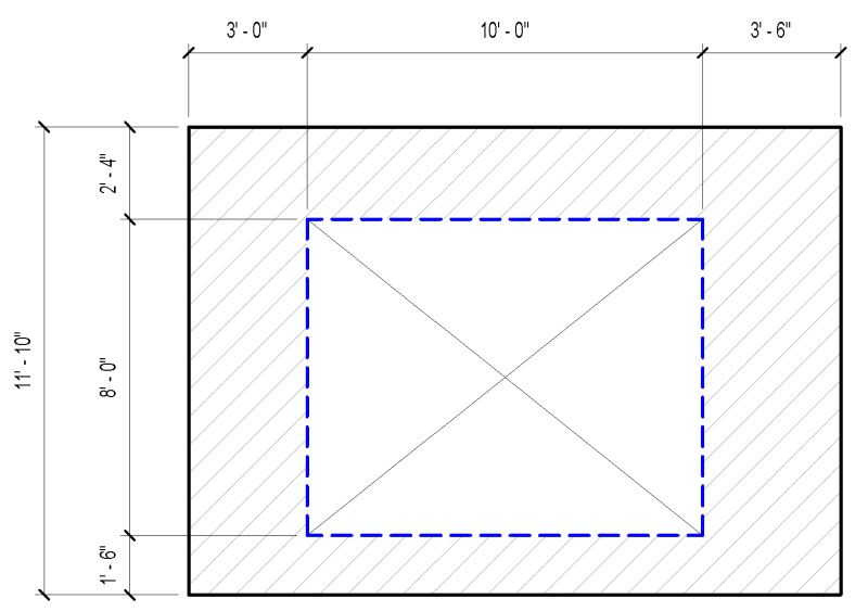

what are the dimensions?
This is basically it. There are some other details that complicate matters, but I don;t want to muddy the waters too much in hopes of keeping this topic a little more generic. I realize there is probably a certain size opening where a supplemental steel frame is warranted, but for the sake of this question I'm more interested in any lower cost solutions that people use to make the numbers work on something like this.

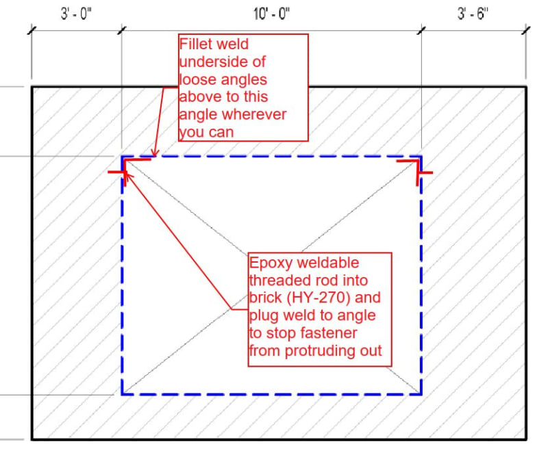

I have two, admittedly not great, options for consideration.
Option A: Corner Angles
What's the clearance between the window and the opening? If you have at least 3/8" for caulking you might be able to get a 1/4" angle to act as a cleat underneath the loose lintels above. Connect the angle to existing masonry with epoxied threaded rod (weldable so you can plug weld it to reduce protrusion into opening). Not super duper but low profile that should be okayish for nominal loading. EDIT - Length of anchor was shown as relatively small but I was thinking you go far enough back to grab several bricks/blocks. Maybe add two or three relatively small anchors to facilitate greater epoxy binding.

I like all the ideas presented, especially the engineering judgment one since it simultaneously solves my problem and feeds my ego. I ended up dealing with this by taking out the entire center portion of the wall from floor to ceiling, then bracketing that opening with full height C5X6.7 jambs. Infilled with CFS framing with proper header and sill anchored to the C5 jambs. The architect is going to wrap it all with something fancy and make it a feature. But I'm still interested in the problem from a general standpoint as I seem to be working on a lot of old brick buildings these days.
