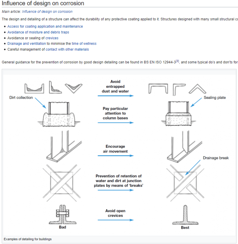

It will come down to cost like the OP mentioned. As far as cost efficient I would probably put my bet on HDG. The other item that needs proper care is the detailing. Better detailing will extend the life of the steel.

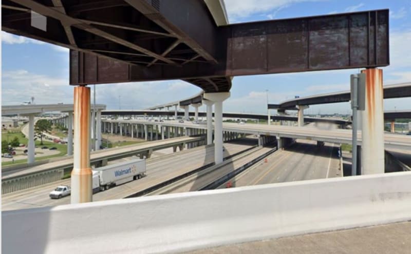

The Texas Department of Transportation (TxDOT) has used weathering steel extensively on bridges.
From a structural and durability point of view, I think they have been very happy. From a cosmetic point of view, they have had a lot of problems with staining of surrounding structures as the weathering steel rusts.
The aesthetics might not matter for your use though.
