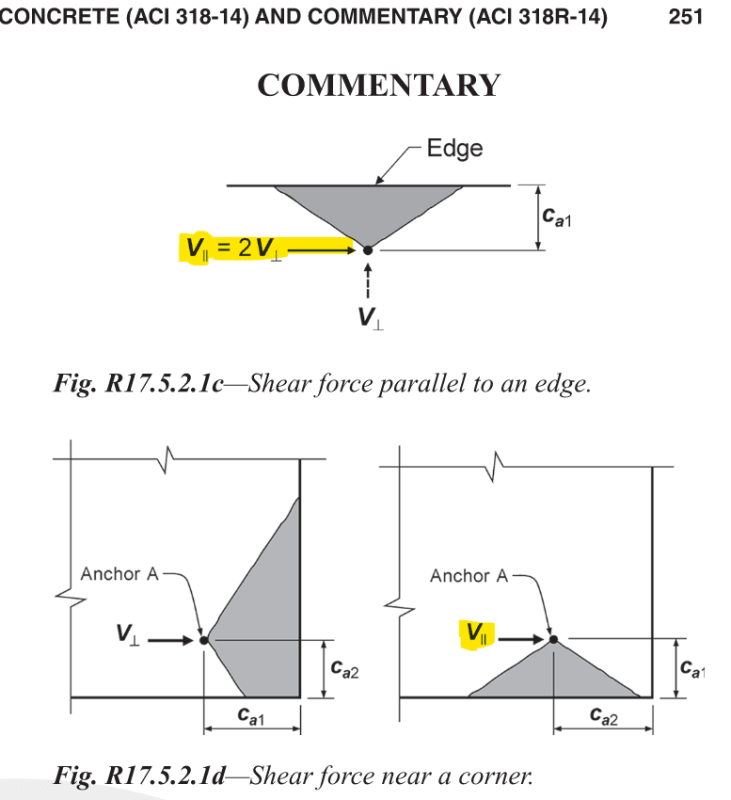

I agree with item #1 for shear parallel to the edge. Any reinforcing I place won't be able to be developed. However, I believe per the Code that the shear capacity for breakout parallel to the edge would be twice that of the capacity perpendicular to the edge, correct? Using this, coupled with item #2 you list should work for my loads.
ChiEngr: Yes, that's exactly correct, per Section 17.5.2.1(c).

Just to be super clear for the benefit of anyone reading this thread, you are referring to this failure mode correct?
That is correct, bones206.

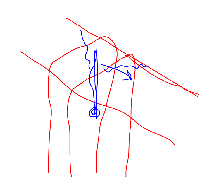

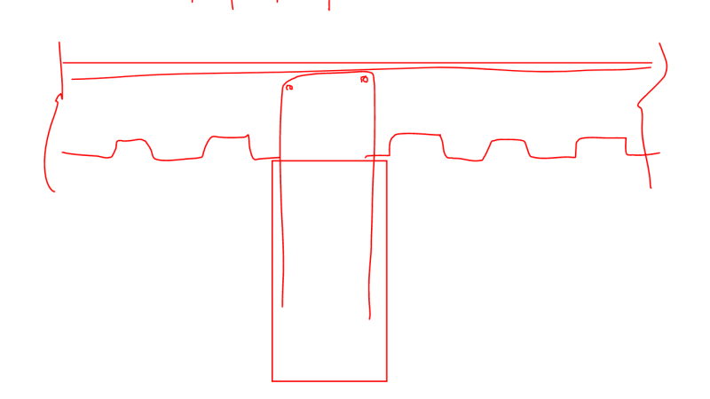

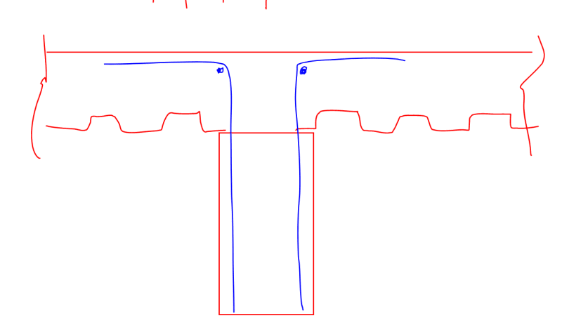

I feel that you could reinforce this adequately if you could manage to locate the hairpins properly, as shown below. This leans on the provision that we use for beam stirrups that imagines near instantaneous development for bars sizes #5 or smaller that are hooked around longitudinal reinforcing.

Thanks, Koot!
I really like your second detail. Didn't even think to implement something like that.
You're welcome ChiEngr.
I'd also contemplated something like this. ACI has provisions now for shear transfer between the flanges and webs of concrete girders. You can move gobs of shear that way. Some testing has indicated that you don't even need reinforcing to get that done. In many ways, this kind of feels like that.
I'm sure that my first detail would be preferred by you contractor over my second.
