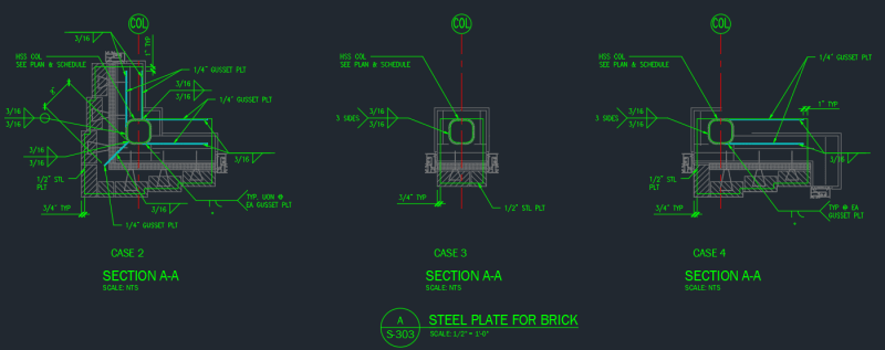

I don't know the application or loading you're looking for, but here's my detail of it for supporting brick:
For such small loads, I didn't calculate the gussets. Only the bending moment (plastic section modulus Z times Fy) and deflection of plate cantilevered out from the gussets. Technically, the plate will be in 2 way bending, but that will need an FEM analysis, which is too complicated for a brick support.
If it was for something substantial like supporting a "walking" column, the column itself will need to be checked for additional moment, as well as the gusset plates, welds, and column web/flange. And then maybe secondary things like overstrength factor...which is somewhat of a questionable thing, but something to think about.

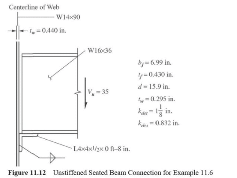

What you're attempting is most commonly done with a seat angle as shown below. The setup is discussed in the AISC Steel Construction Manual, complete with tabulated capacities.
