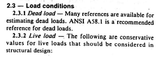

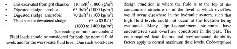

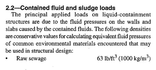

Is the unit weight of raw sewage no longer in the design standard (ACI 350)? I have a 1989 photocopy and there's a section on live loads 2.3.2 that gives unit weights, I can't find this provision in, say, 2001.
@lexpatrie thank you very much for posting this question, you helped me indirectly. I was looking for some authentic source for these unit weights and couldn't find them in newer editions and never looked in such older editions. Can you please mention the clause for my ease?
