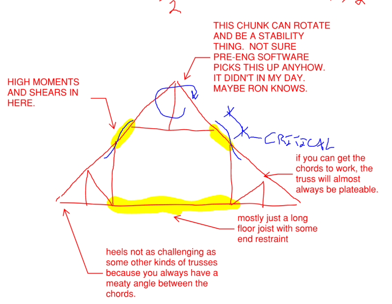

I'd recommend that you create your own FEM template in order to prelim design these things yourself. I feel that's possible precisely because the hardest working parts of an attic truss are the parts that are, in fact, not trussed. See below. So long as you pick 2x8,10,12 lumber grades typical of trusses in your area, I would have every expectation that a phamattic truss would be supplier workable. Bracing assumptions are critical, as you can imagine. I don't see that tripping you up though.
Pretty much everything comes down to the clear spans of the top and bottom chords between joints. That's part of what makes it difficult to come up with rules of thumb that don't wind up being punitively conservative. You can, of course, use multi ply trusses if your project can absorb the cost of that. Trusses can sometimes also be designed so long that they can't be shipped, at least not in one piece.

I stumbled across this when looking for span tables and thought it curious with respect to the reinforcing of the truss top chord across the non-trussed zone. I feel that it's misguided. It's not like a 2x8 can't span 3' or whatever as a regular beam. And I'd expect the reinforcing to help very little with the Vierendeel action that is the real plague of the attic top chord.
It probably won't surprise you that I have some pretty strong opinions about this. [glasses]

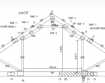

KootK - I just saw the drawing that you posted late last night.
In the past I've been asked to plate lumber under the TC to increase the effective depth of it for insulation purposes. I doubt that member was intended to be any kind of reinforcement.
I also noted that W6 is one of those tiny, useless kingposts that I was ranting about above. [glasses]
KootK - thank you for that. Looks like Ron has a pretty good idea for the real reason behind those added members. It's actually a pretty good idea for insulation purposes...
Ahh... that makes great sense, thank you. My attic truss design experience mostly predates the "age of insulation".

ETA - I think some of the "extraneous" pieces you're seeing are a) for insulation depth, b) for shipping/lifting or the size of the toothed plate.
