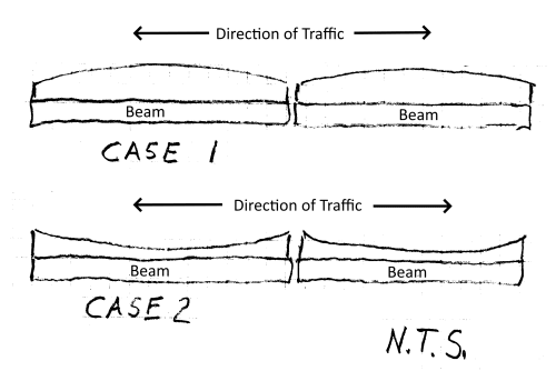

Good day all.
I am required to prepare a table of screed elevations for a bridge deck. These are the steps I am thinking of in my calculation. Kindly advise if this is correct and complete.
Step 1: From proposed final roadway centreline elevations, subtract thickness of asphalt to get top-of-concrete elevations. Do this for ten points in one span. These are screed points.
Step 2: Do a structural analysis of the centre girder (bare girder only – not composite) subjected to following dead loads. Use the girder’s tributary width for the weight of wet concrete and weight of asphalt. Also include the parapet and sidewalk weight (assumed smeared equivalently over the entire deck) in the girder’s tributary width.
(Some people say only include wet concrete weight ??)
Find the deflection at each of the screed points.
Do not include girder self weight. This is because girder self weight deflection is already included in the camber.
Step 3: Add these deflection values to the top-of-concrete elevations of Step 1. The resulting elevations are screed point elevations above the center girder.
Step 4: From known transverse slope of the deck from the center (crown), calculate screed elevations along other lines of girders, and along the edge of the parapet (where screed rail will be placed).
If anyone can share guidelines, spreadsheets, or example calculations, that will also be much appreciated

I believe you have it covered. Of course you want to get the settings exactly right, but if there is an error, make sure it results in a surface profile like Case 1 (shown below). Including everything in the calcs is the best way to make this happen. A surface profile like Case 2 rides "terrible" and will result in an endless stream of complaints. The same magnitude error in Case 1 is, for some reason, is not considered nearly as bad a problem.
Advice straight from my father (highway bridge construction management 1935 - 1976) to me.
Edit: Relabeled sketch to clarify that this is a longitudinal section of bridge deck.

@SlideRuleEra: Thank you very much for your reply. We will definitely try to avoid Case 2, which could create a water pond in summer and an ice rink in winter.
@BridgeSmith: Thank you very much for the detailed reply. We will use bare girder in the computer model to determine wet concrete (deck and haunch) deflection (delta 1). We will use composite girder to determine superimposed deadloads (asphalt, parapet, sidewalk) deflection - delta 2. To simulate composite action, we will modify the Second Moment of Area (I) of the bare girders by a multiplier. This multiplier is the ratio of (I_comp / I_bare). In computing I_comp, We will use long term concrete Modulus of Elasticity, which is about a third of the initial concrete MOE. We will add the total deflection (delta 1 + delta 2) to the proposed top-of-concrete elevation to get the screed elevation.

Makes sense, tmalik3156. The deflection calculation you describe sounds right to me. We typically just use 3 times the modular ratio (3n, where n = Es /Ec) to transform the concrete to an equivalent area of steel for the calculation of I-comp. For calculation purposes, essentially, we add a 'steel cover plate' that is the height of the slab and 1 / (3*n) of the effective concrete flange width.
The rest of the approach also makes sense for redecking on existing girders.
