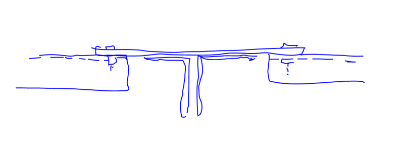

b) I haven't tried it yet but have been envisioning something like the detail shown below. The bolts would be removed after the welds are made. I anticipate pushback, groaning, and eye rolling. Note that the channels and patch plate need to be sort of moment connected in order to keep the whole thing from folding up like an accordion. One also does not love welding transversely to the chord of a joist carrying truss dead load. Maybe a screw connection would be worked out or something. Obviously, in compression, the joist is bracing the strut.

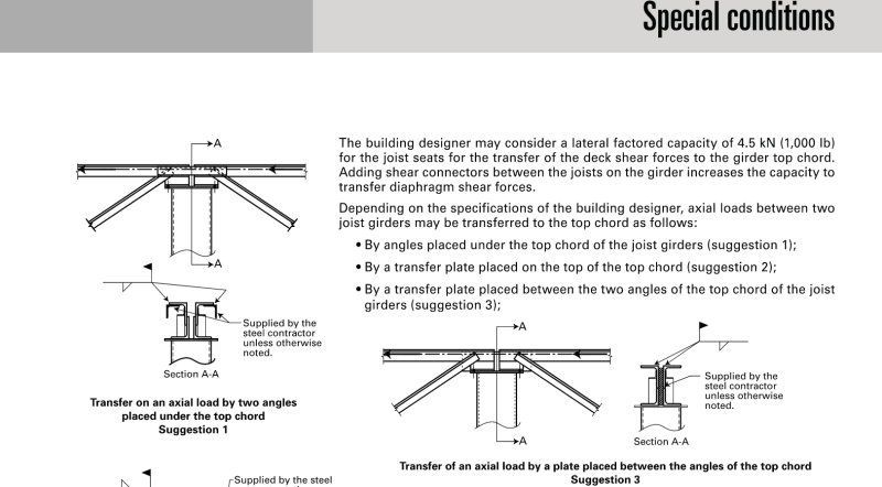

The joists themselves have some demonstrable rollover resistance, see the Vulcraft "Designing with Steel joists" 3rd edition, Chapter 7, and the "customary" detail that is shown in the Vulcraft book is a tube steel section (HSS). You have to kind of adapt this into whatever you have beneath the joists, but I suppose with a lateral system in one spot only along the whole side of the building it's a steel frame under it, then the drag strut is the steel beam supporting the joist. Path through any interrupting columns, etc, but you have a longer distance to get the load out of the diaphragm and through into the braced/moment frame in one bay you depict.
Regards,
Brian
We will be using Canam joists with 4" seats. Given the spans in this case I expect something like a double L2x2x3/16" or so for the top chords. We can get Vulcraft, but they are not usually competitive in our area. The typical seat data from Canam is below. Generally, most in Canada provide alternate means for these type of details. RFI's can go a bit mad if you stray from their standard details.

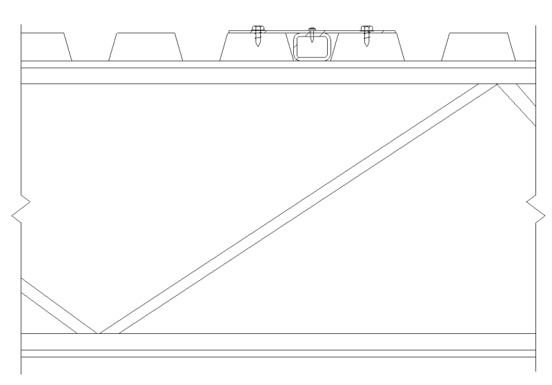

I haven't had a need for this type of drag strut away from a beam line, but I'll throw out this idea for consideration. Basically jayrod12's plate beefed up with a tube that can fit in the low flute. This would be constructed above the deck with no welding required (except at the strut ends probably). I don't necessarily see a need to weld the strut to the joists, since the deck is already fastened to the joists and the strut is fastened to the deck.
Bones, that is quite a nice detail. Easily done after decking and shot down. Thank you.

I don't love it. I think this is a case of "if it were that easy, we'd already be doing it this way". Issues that I see:
1) How do you splice the HSS when you inevitably need to?
2) How do you connect the HSS to the braced frame beam or whatever below? This, particularly given that one usually is not able to exert control over the locations of the deck flutes in plan.
3) These struts can have loads in them in the 20kip+ range at times. I would not feel good about relying on the pullout capacity of a few deck screws performing the bracing function for loads of that sort.
