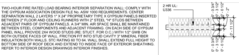

You don't have a common wall you have a double wall per R302.2.1 so exception 5 of R302.2.6 does not apply and each townhome must be structurally independent.

Interesting. I was under the assumption that the typical party wall details I see on townhomes are IRC 302.2.2 common walls, but not my area of expertise so I'm probably wrong. I typically see the detail shown below. Do you know if that is a "double wall" or a "common wall"? I just tried searching online for an answer, but I couldn't find anything definitive.
