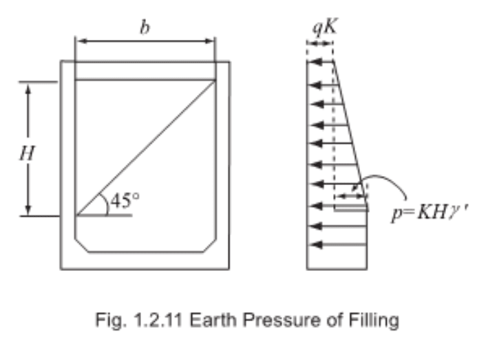

This thread presented the method for handling retaining wall loads in a confined spaced.
thread255-498131
The solution was to limit the lateral pressure magnitude to the dimension of the overall retained width. This would cap the pressure for any depth that fell below the dimension b:

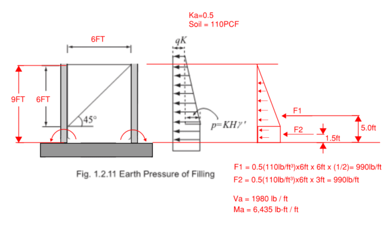

Now the question comes up, if these walls sit on a combined footing, how does the foundation share the load? There will be opposing OTM and outward shear on each side of the footing.
The applied reactions for the single sided analogy are:
Va = 1980 lb/ft
Ma = 6,435 lb-ft/ft
To me, these forces just get internalized into a classic bending moment in the footing and tension force.
I can't envision how designing it as full wouldn't produce a design result greater/more conservative than what you have shown.
Yes, to me it's also very conservative to apply Va and Ma to both sides of the footing at the same time.
Is there a way to lessen these into shared forces?

Western, I'm assuming it will be filled to the brim. I guess my question has more to do with what Ma and Va you'd apply to the top of the combined footing on each side. While this is an actual design I'm handling right now, it feels like a silly theoretical problem a group of engineers would debate on.

In the interest of design efficiency, I'd be inclined to just pretend that one wall isn't there and design everything like a classic retaining wall. If you want to avail yourself of the reduced soil pressure associated with the limited backfill extent, go nuts. Then just make the thing symmetrical.

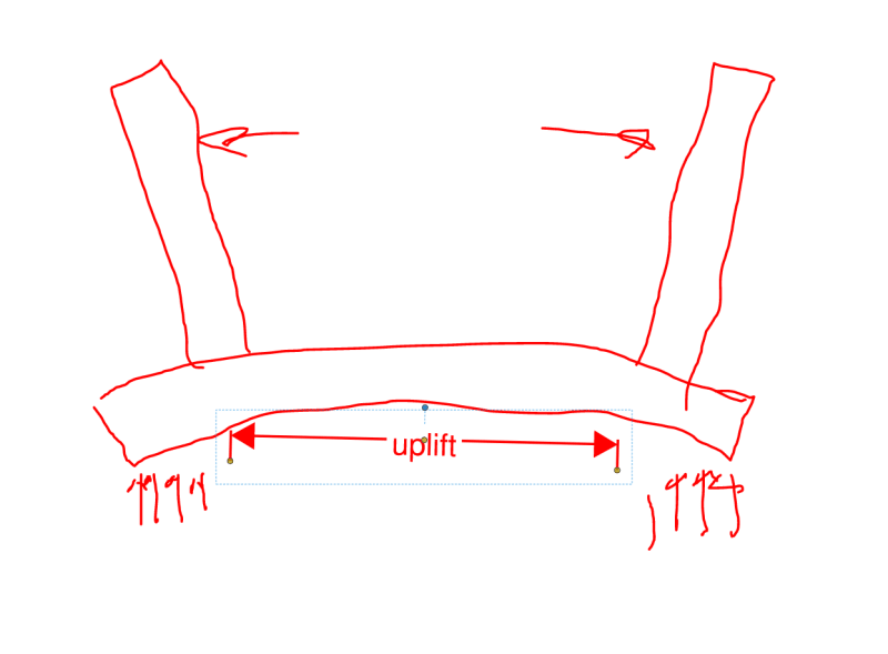

The question was how the foundation shares the load, if you follow the typical rigid foundation approach the moments would cancel and you’d get uniform bearing. If the foundation isn’t rigid then I’d think the moments would tend to lead to higher bearing out towards the toes. (The classic retaining wall approach for each side might be reasonable, I’d have to run the numbers the different ways to satisfy myself)
Certainly. So much so that I suspect that most of the footing would be in a state of uplifting from the soil which, in my mind, would pretty much neuter the validity of beam on elastic unless it's a pretty sophisticated version of that. For the sake of looking at soil stresses and toe forces, I'd think this to be nearly as meaningful. If the dead load prevents footing separation of the soil interface, so much the better.
