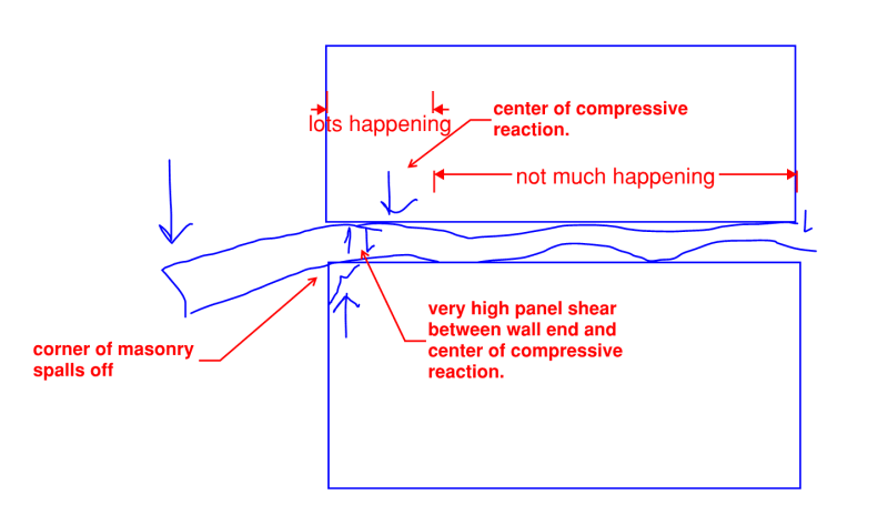

The 7'-0" wall is one of the shear wall which will deal with the in-plane loads itself with rebar. Rebar will run through the beam flanges to reach the development length.
My answer would be that you don't want to do this. This condition would set up a terrible, and unpredictable, prying mechanism between the beam and the CMU. And that could potentially damage both the beam and the CMU. I feel that you need a different, overall scheme for this.

Also, what kind of mechanism would you say is the potential hazard?
See the sketch below that I struggled mightily to draw in a persuasive manner. Basically just the effects of the prying action that I mentioned previously.

Kootk, thanks for the sketch, and I agree with you. I thought about that when I asked about the support conditions. This is a residential building in NYC, a typical 20' width building.
Currently, the main load is the CMU wall itself and the window dead weights. The beam size is at W12x30 now.
