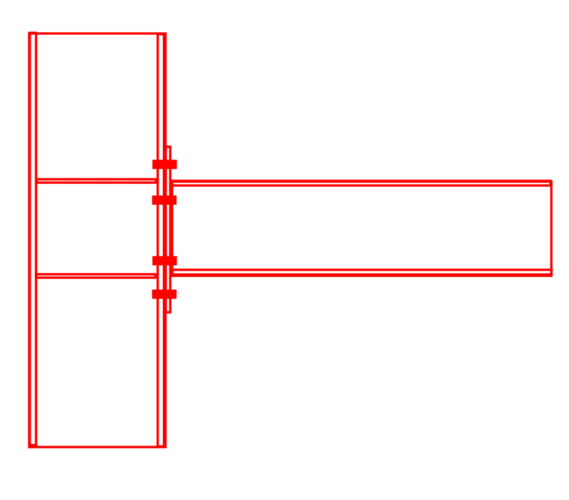

I have this I section steel beam to I section steel column using bolted moment connection.
I am wondering what happens if this moment connection fails? For the structure itself, shear connection is okay, but for some reason it is designed as moment connection but don't have enough moment capacity.
What failure mode is the connection failing under?
Can you post a sketch of the connection as well?

It is a typical 8-bolt moment connection.
It fails at the connection (end plate yield and bolt tension)
The structure is checked using shear connection and it is ok. It is more to do with what will happen after the connection fails? Can I say it will simply becomes a hinge so as long as the connection can still take the shear then it is ok?
I don't think that would be accurate with an end plate moment connection. A flange bolted or welded moment connection with separate components for the shear transfer, probably...but I wouldn't want to count on the post-failure remnants of this to do anything reliably.

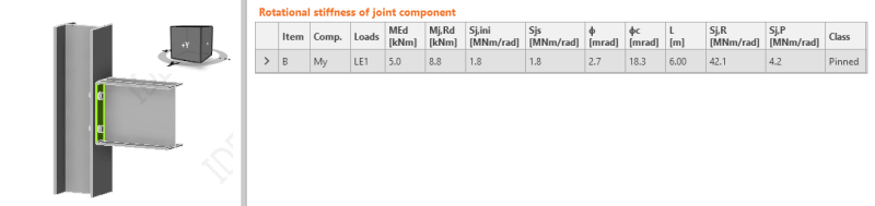

I would happily count on in many circumstances. For example remove the exterior bolts and call it a flexible end plate and it will likely meet the requirements of a flexible end plate. As shown below.
(I've been busy recently designing both flexible and moment HSS to HSS joints. So joint stiffness and behaviour has been on my mind recently)
