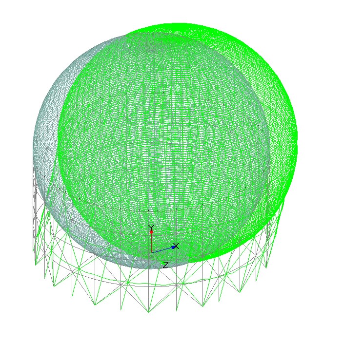

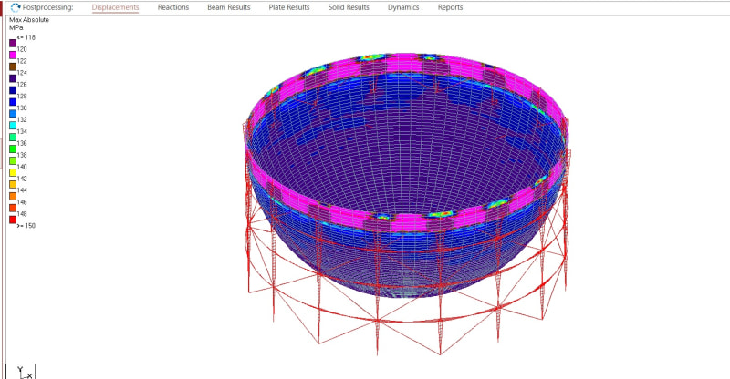

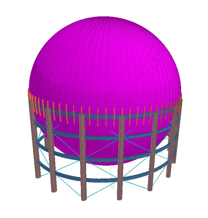

Vessel Design and Analysis
its about spherical tank design and analysis
other questions
- is how are dealing with ring beam region localized stress ?
adding stiffeners (tee or u shape) sections ?
- whats is the maximum drift ratio for such structures (due to winds)
- how seismic loading affect your design of storage shell ? (what software is best for such loadings)
