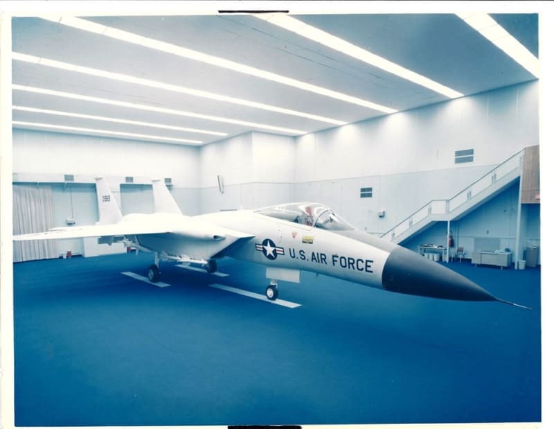

Which reminds me: has anyone else ever seen this early USAF/Naval-capable F-15 concept? Here it is... an early F-15 mockup with shortened V-Stabs and ventral fins and squat-landing gear and outer wings that would-have folded-up.
No, but I'd love it if you could box that one up for us to go. It would look absolutely great in the company boardroom.
