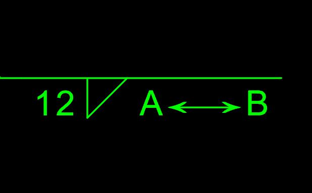

On a drawing I need to specify a weld symbol that denotes welding between two points.
Is there a simple way to do what is shown below?
I am on NX1899
Jerry J.
UGV5-NX1899
I was able to find a way to do it, but I am still interested in hearing about a better way.
I used an ascii symbol and changed the aspect ratio using <Y2.5> and the character size using <C.9> and it looks good.
A<C.9><Y2.5>↔<Y><C>B
