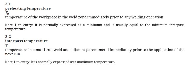

It would appear that reference to a terms and definitions, or vocabulary, standard is required to confirm the specific difference between 'preheat temperature', and 'interpass temperature.' Try AWS A3.0, or ISO TR 25901-1.

Good point. Sec IX defines preheat temperature as follows:
'The minimum temperature in the weld joint preparation immediately prior to the welding; or in the case of multiple pass welds, the minimum temperature in the section of the previously deposited weld metal, immediately prior to welding.'
So, @DekDee, refer your quote: 'All other temperature readings are interpass temperatures unless welding is interrupted.' - is not quite correct, I think, at least in the context of Sec IX. IMHO, interpass is a supplementary essential variable, and comes into play only when toughness is a consideration. One can forget about interpass temp. otherwise.
In ordinary multipass welding, the preheat temperature is not just the temp. before deposition of the first pass, but is in fact the temp. before any pass is deposited. Correct me if you disagree, please.
How does that gel against the definition of interpass temperature, also in ASME IX?

QG-109.2 DEFINITIONS
preheating: the application of heat to the base metal immediately
before a welding or cutting operation to
achieve a specified minimum preheat temperature.
I think that is pretty clear preheat is applied by means other than welding.
I think this clause is confusing (especially when we look at interpass)
I have added in the bold
preheat temperature: the minimum temperature in the
or in the case of multiple pass welds, where welding has been interrupted the minimum temperature
