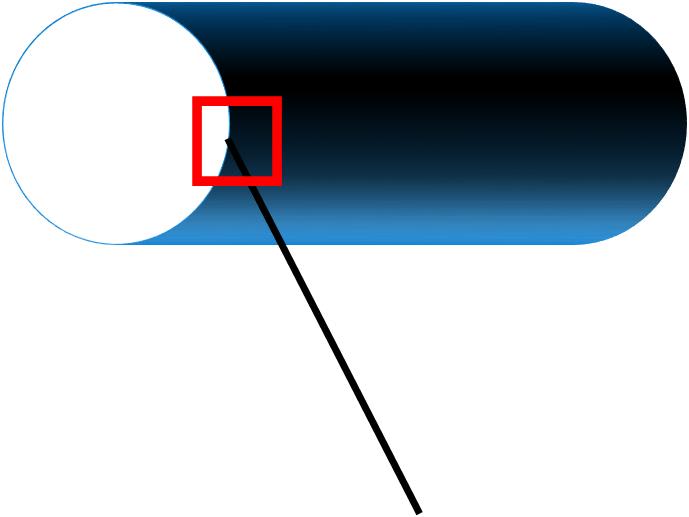

Dear experts, I would like to ask how to constrain the contact between the truss unit and the surface of the cylinder shell in ABAQUS in a reasonable way? I tried to use a mpc pin connection between the endpoints of the truss unit and a bit of the shell unit, but this results in a large stress concentration, which is not what I want. If I use the endpoints of the truss to connect to the surface of the shell at multiple points, the center of the piece will become rigid and all the stresses will be 0, which is not what I want. I would like to ask you experts if there is a good solution for this?

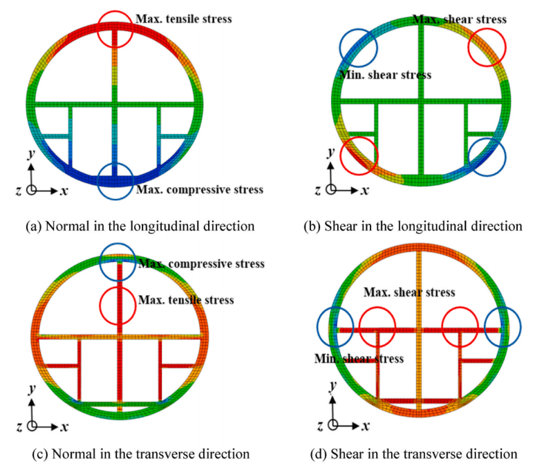

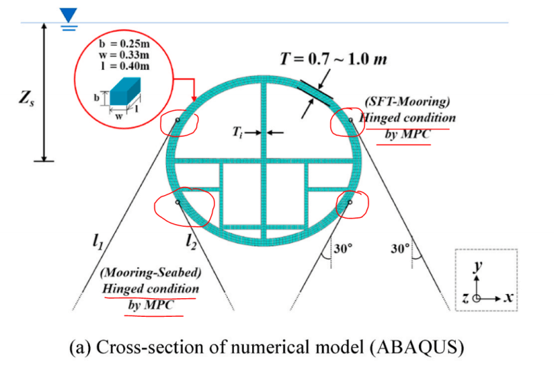

But I've seen an article where it didn't use the connector approach and there were no stress concentrations. Why?
Doesn’t the article describe the details about the way those connections were realized ? Also, I don’t think they used shells here.
This article uses beams element and the solid element to connect. The connection between them in the article is an mpc pin. Only the displacement degrees of freedom are controlled. So I don't understand why it doesn't have stress concentrations? I don't think the type of the element used is relevant.
ask the authors exactly what they did ?
