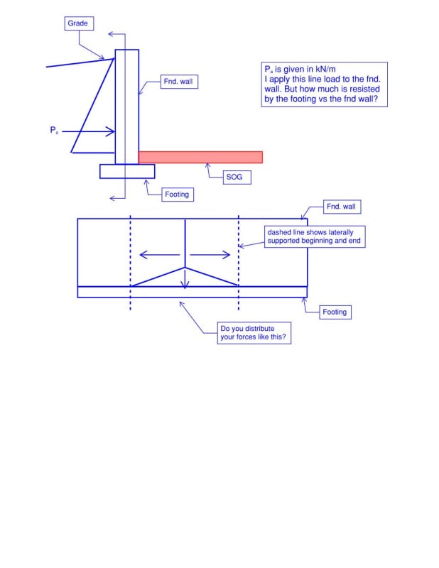

Another question. Do you assume that part of the lateral force is resisted by the footing rather than the fnd wall? I find the design quite conservative if I assume the fnd. wall to take the whole load. Below is a sketch. Is there any guidance document on this?
I know of no direct document guidance on it. Tends to be a "what you're comfortable with" type design.
Although I understand the point about negative bending on the outside face of the wall if considered fixed ends, however I then would ask, what's the outcome if it's not reinforced there? In my mind it's some flexural cracking on the outside face of the wall. To me, those would usually be acceptable as there is a waterproofing/dampproofing installed on the outside, and the cracks would not project through the entire wall so no leakage potential.
But again, situationally dependent. It also would depend on how far it needs to span.
