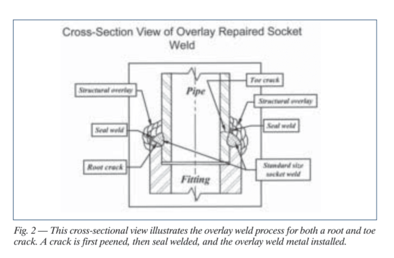

our contractor looks for a common way how to weld a 3/4" pipe (304) into a 3/4 "sockolet (304). The gap between sockolet and inserted pipe is to small (~0.1mm) to purge the oxygen completely with forming gas. There will be a risk of crevice corrosion. The pipe (3") uses many sockolets so it is not possiple to purge from the 3" pipe due to all the holes of the sockolets. It is very time consuming.
Any practical solution like drilling a small hole on the side of the sockolet to easier purge?
I guess there is a common used way to do it.

There is absolutely no reason to purge a socket weld, even if it is stainless steel. You are only wasting purge gas doing this.
The practical solution is to stop purging all together.

Because of the inability to get an adequate purge; just like the problem you’re having.

If socket welding is a wrong design (as I said before) why use a backup gas that is for a good design (butt welding)?
Has no sense.

You need to make sure that the pipe does not bottom out in the socket.
There is a required gap after welding.

If there is concern of crevice corrosion, then a socket welded joint is a poor choice, as indicated by r6155. By design, socket welds always have crevice.
That depends on the customer requirements. Most codes state that the gap has to be present prior to welding only. Recently, B31.3 went as far as stating directly that gap is not required to be present or verified after welding. I’ve seen the “after welding” requirement in some customer specifications.

An import requirement for socket weld is that the pipe MUST NOT bottom out in the fitting. Leave a 1/16th inch gap. This is difficult to control in the field. Welding without a gap leaves residual stress in the weld which will cause it to crack if it is exposed to cyclic stresses.
