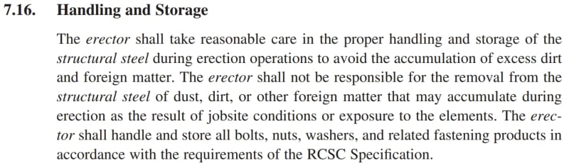

Look at 7.16 Storage and handling in the AISC Code of standard Practice (and commentary) If the notes or specs or contract general conditions s tie the contractor to the AISC specs or Code the that might be some leverage on them.

From the AISC Code of Standard Practice... my old copy was a decade old... Looks like a General Contractor problem...

Perfect! That article gave me the spec section I was looking for. I knew there had to be a section on that somewhere.
Thanks!
"When water can collect inside HSS or box members, either during construction or during service, the member shall be sealed, provided with a drain hole at the base, or otherwise protected from water infiltration."
