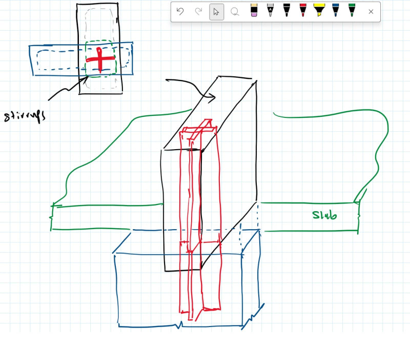

Milk-shake-lake, you could look at it as mechanical engineer.
small toy where their head twisted !!! what keep it standing and strong.
pin-mechanism, where you could add (+) structural plated section inside the edge of bot column and extended to the above column
then add some close spaced stirrups (for lateral confinement). and you will get highly efficient joint interim of strength vertically and laterally.

@ALK2415 That's a cool detail, thanks for taking time to sketch it. I believe I can rely on column rebar to achieve the same thing. I'm not particularly worried about lateral shear, which is the main thing it solves. And I agree that there needs to be more research done about this, especially when other engineers are walking the column with seemingly no consideration.
