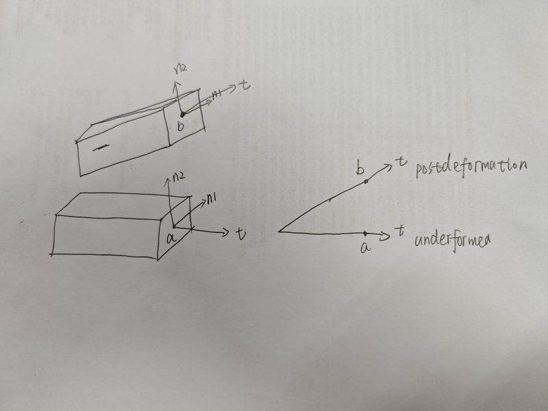

In ABAQUS, is the SF and SM of the nodes output from the beam model based on the post-deformation beam local coordinate system or the pre-deformation beam local coordinate system. If it is a post-deformation beam local coordinate system, does this mean that the orientation of this coordinate system will gradually change with deformation?

In the figure below, when the beam element has a large displacement, the local coordinate is which of the coordinates a or b in the figure?
Depends on the specific output variable.
Element results like forces and stresses are output in the element coordinate system.
Nodal results such as displacements are output in the nodal coordinate system, which can be either the global coord system or a local coord system. For large displacement analyses, I think there is an option to output nodal results in the displaced coordinate orientations.
I think b) only if large displacements is turned on. Normal (small displacements) is a) ... the elements don't displace (in a global sense).
But in any case the internal loads are still applied in the element local axes ... the local axes deflect with the element ... "t" is tension in both cases.
