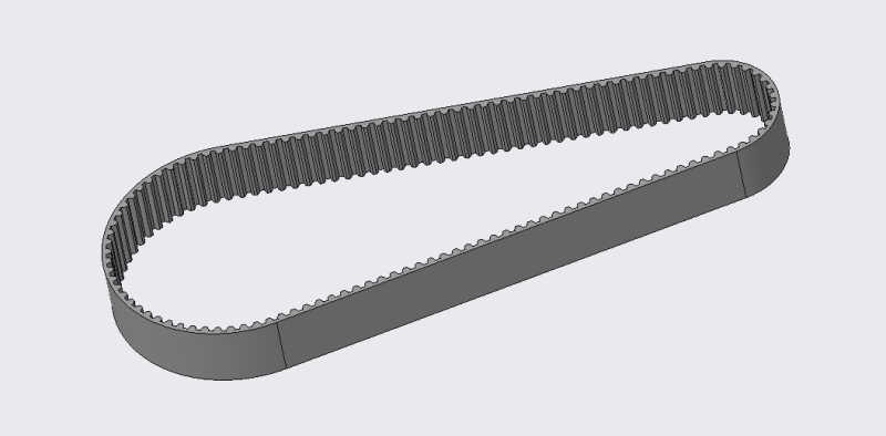

I've created a timing belt path.
Established a pattern consisting of equally groups equally spaced. Each group contains a points and an an axis through that group and normal to the belt inside surface. I adjusted the display on the axis so that the axis points inward.
I then created a belt tooth feature referencing ONLY the pattern's first group's point and axis and then reference patterned that tooth feature.
I don't understand why this isn't patterning properly.
Attached are a couple of screenshots and the file.
Thank you for your help!
It's because the requirements are not well defined. Each little bump is on the point and axis and the surface. The problem is that it doesn't have a notion of which way is the surface.
I would be tempted to do this using a spinal bend. Create the full length belt as a straight item and then spinal bend it to match the desired path.

I got the model working.
What it needed as part of the pattern group was a Datum Plane through the point, normal to the axis, and normal to the default front plane. This datum plane gave each of the tooth an absolute direction dictated by the front/back of the Datum plane rather than the ambiguity offered by the axis.
From the working model I showed in the previous post I found an embedded (undefined?) DTM 1 that provided this direction reference. In that model though, I didn't see how DTM 1 was defined.
Thanks!
