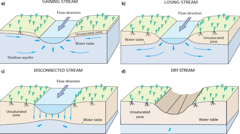

2) Groundwater levels adjacent to a stream may be higher, or lower. You have to recognise that water levels can be dynamic, especially throughout the yearly seasons. The classic illustrations usually show a stream water level lower than the groundwater level, which signifies the stream is draining the local groundwater. However when a stream is charging groundwater, stream surfaces are higher than groundwater levels. Higher stream levels are typical during spring rainy and snow melt season when surface runoff is greater and groundwater supplies are being recharged. Lower stream levels are typical during summer when rainfall is usually less and water runoff is reduces by evaporation by higher temperatures. That will tend to drain the groundwater whenever stream levels are lower than groundwater levels.
Water levels may also vary considerably along a stream's course. Some areas may be recharging groundwater, others draining it. That is typical of a changing topography. A stream level 5 ft higher than groundwater indicates that the stream is charging the groundwater at that point in the river. 5ft difference at average stream flow levels is relatively large, so it indicates the stream could be permanently recharging groundwater

What is the soil type? If you are in sand, I would expect the water level to be very close to stream surface. If you are in clay, who knows, but it is going to change with time.
The geo report should explain that the water level is likely to change, and the construction crews should be prepared to address those changes. The contract is not always written to include those factors. If these factors are not in the contract, it's an extra payment for the extra work.
